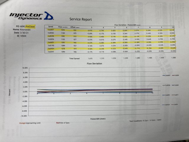

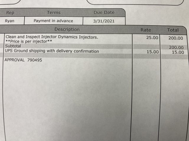

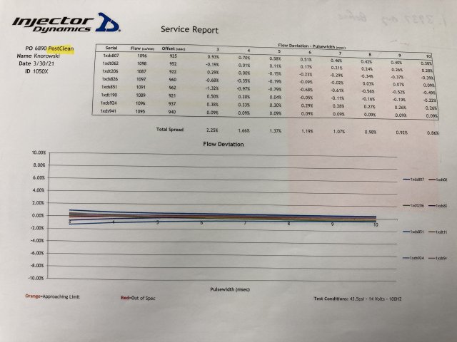

How much to clean them? I have never sent a set out to get cleaned. My friend Tim sent his out running 8's on e85 this year and before and after flow was basically the same
I sent my ID 1050X’s to ID for cleaning, about 9,000 miles on 93, 4000 on corn, as sent basically same as returned. Interesting thing was for 1050’s they flowed almost 1100 cc’s, no wonder they keep up with E85 and 18 psi of boost. 6BAA33E3-8B91-4949-9EA6-BD7E054D2F86.jpeg B2D65CCC-0AEA-4B13-A7D2-41D9E17DC4DF.jpeg 2D67E8F7-1A50-4B66-8A16-4AFF522D7A59.jpeg

At what PSI?? Most places test at only 43.5psi
It’s on the reports, bottom right, 43.5 psi 14 volts 100 hz
