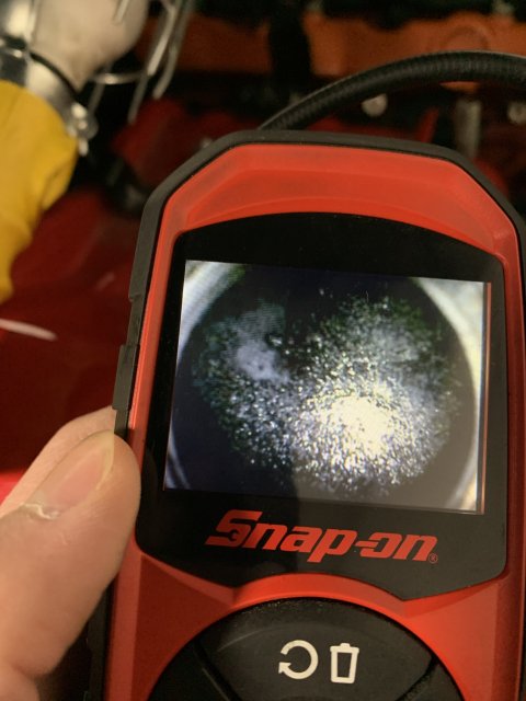

I'd scope it to see if you can see anything.
Well the only note scope I got my hands on was a snap on one and I struggled to see much

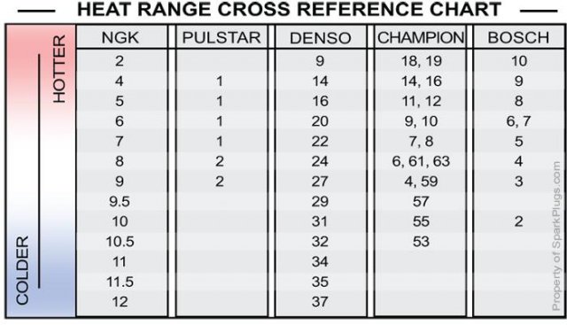

According to Bosch cross reference a 6,7 bosch is the same as a NGK 6. Most plugs getting colder the higher the number, bosch the lower the number is colder
Shows a NGK 7 is the same as a bosch 5

That was the chart I saw

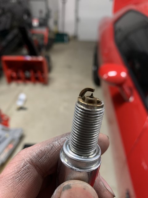

@Speedy! i know how much you like octane boost pics.
I had some in the car because I ran it around on 93 a bit for storage and put octane booster in. Well just have backing out of the garage and running it. Here is a brand new plug with 10 minutes of run time.

Looks good to me

Just stained a little bit nothing crazy.
I hope your #4 recovers for ya.
How much boostane did you use ?
I normally use 2 > 2.5 oz. to 8 gal.
I don’t remember. I think I just dumped some in because I wanted to get a few last pulls in before it snowed 😂

10min on a new plug?
Looks dirty to me...
.01
I don't think they stay new & shiny looking very long.
10 min. of hammering down :LOL:

So the verdict is the NGK plugs you got is same as stock ?
I beleive they are a step colder. Look at the chart I posted. The ones we bought are Ngk 7.

Another thing I feel if the cylinder was bad the plug would be oily. So I am feeling extremely confident the engine is fine.
Good, but what you think caused the plug to desenagrate like that ?
OK the NGK 6 would be same as Bosch 6, got it.
It is more confusing than it has to be. If it helps here is the part number from my stock plug Fr7s1332

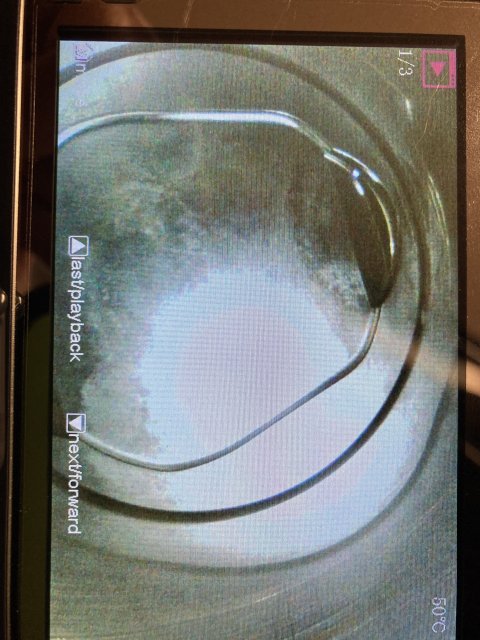

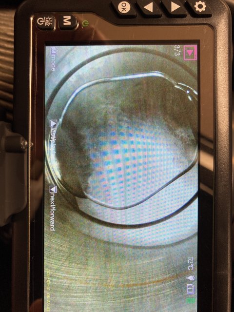

3,798
8,995
Need one like this, and this is a picture of the picture on the scopes screen, with the protective scrim still on it!! . Camera resolution is 2180, and it takes movies too! Articulates 360 degrees 7525A4A3-3E20-485A-A233-6DCCF6CCECC7.jpeg 7083F35E-BC04-41DC-A138-4AA88E009DF4.jpeg
