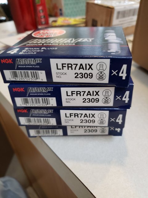

Much cheaper then some other places selling them as a set. They were like $6 a plug

I read there were some fake ones on amazon so I wasn't going there to buy plugs

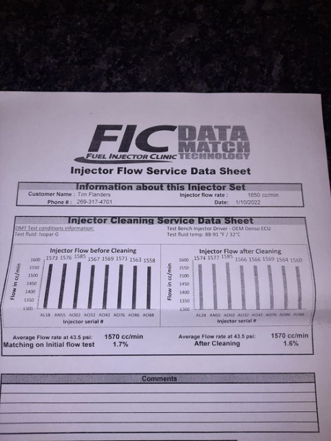

How much to clean them? I have never sent a set out to get cleaned. My friend Tim sent his out running 8's on e85 this year and before and after flow was basically the same

Test and clean, and shipping, @ Havoc Speed - $175.59

I also believe we got a deal for qty
think it was 4 plugs cheaper then 1 per plug but after 4 I don't think it mattered

I've got a whole box of plugs from Orange Krush. I need to go out and see what they are, 2309s I think. Back in the day you had to be careful to use the right plug as some were taper seat (SRT 6.1 blocks) and some were gasket seat (5.7 blocks). I'm remembering the Hellcat is gasket seat.
When I was looking around at plugs there was a guy that said his tuner told him to get a certain NGK. I pulled it up and compared it to the 2309 and the difference was it had a tapered seat. It was the same heat range. The Hellcat uses gasket seat like the 2309
