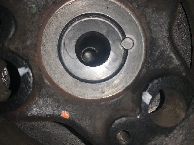

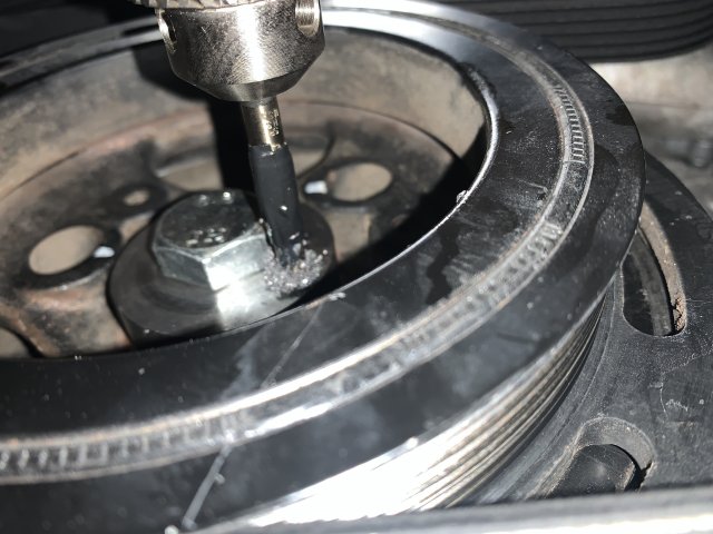

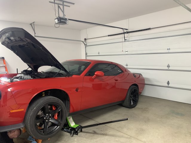

Pretty productive day. Thanks @vortecd for the help all day. We got his stock axle taken out he let me borrow after I broke mine. We then put the new gforce outlaws in. We then move to the front of the car and drilled a hole and pinned the crank. All in a good days fun. We were curious what the new bolt torque was after the 150 degrees. It is somewhere between 200 and 230 ft lbs. we set it to 200 and it clicked. We set it to 230 and it never clicked. So we are unsure. My digital torque wrench is only a 3/8 so we didn’t use that for the 150 degrees. we torques it down with my 1/2in torque wrench because the adapter would through the torque off a little. We then did the degrees with his 3/4 torque wrench which we didn’t have the proper socket for so we used an adapter.

Nice cut. I clicked mine at 300nm or ~221ft/lbs. The 150deg with the mirror was a pain for me.

I just noticed, shouldn't the pin be flush with the inner groove so the washer seats all the way? Sorry, I'm just lookin out.
