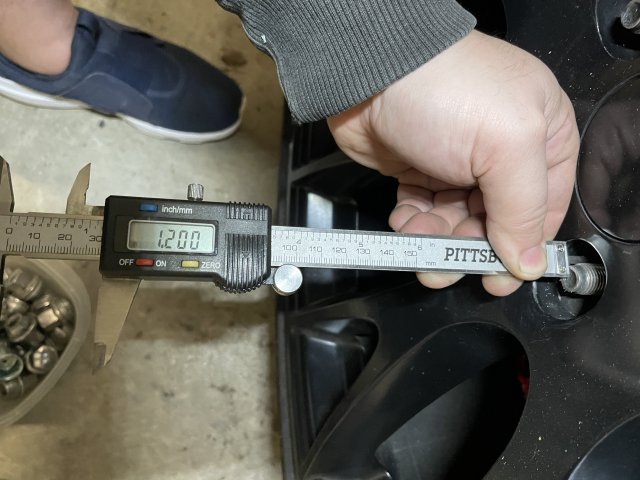

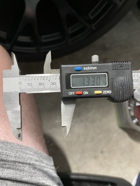

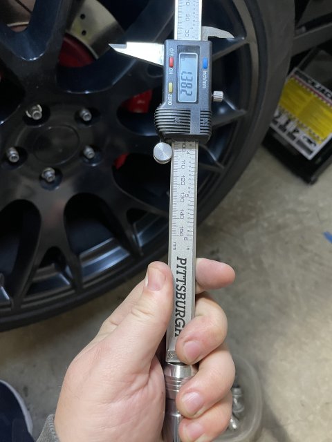

Tightened on open lug so it was snug, measured depth to bottom out.
Wheel locks are okay…
went into the collection and found ones with depth that would work
Running the dorman ones sold on HHP website with a 12mm spacer
