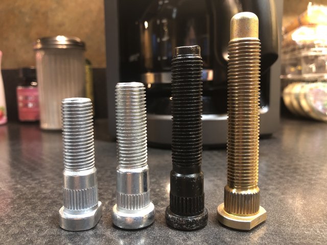

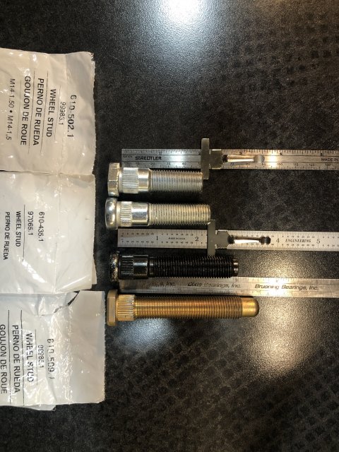

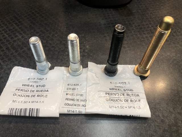

I think I found the stud that will work for my needs. From left to right is Doorman stock replacement 610-502 at 50 mm stud length
Doorman 610-435 with is about 8 mm longer then stock
Doorman 610-509 which is about 25 mm longer then stock
And ARP stud which is about 45 mm longer then stock but knurl pilot is not present
Going to be using the 610-435

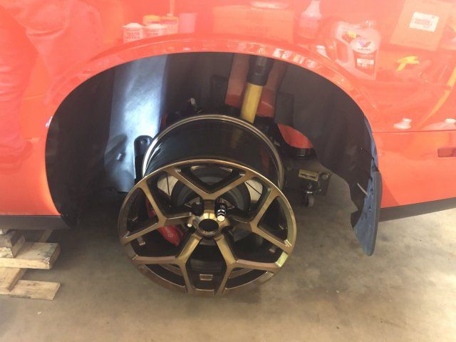

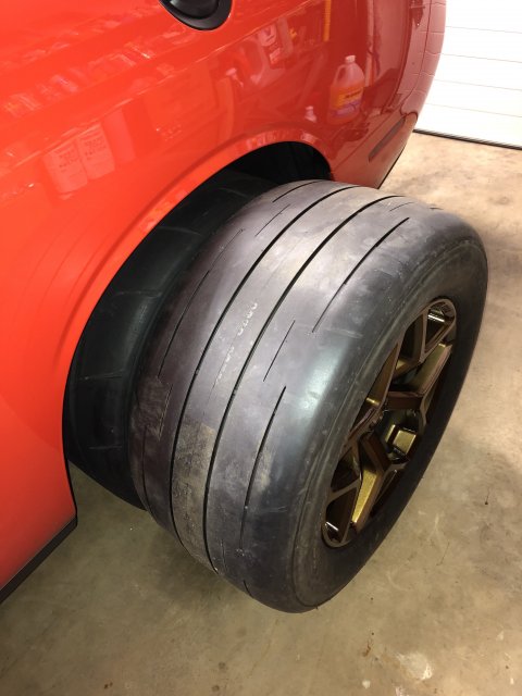

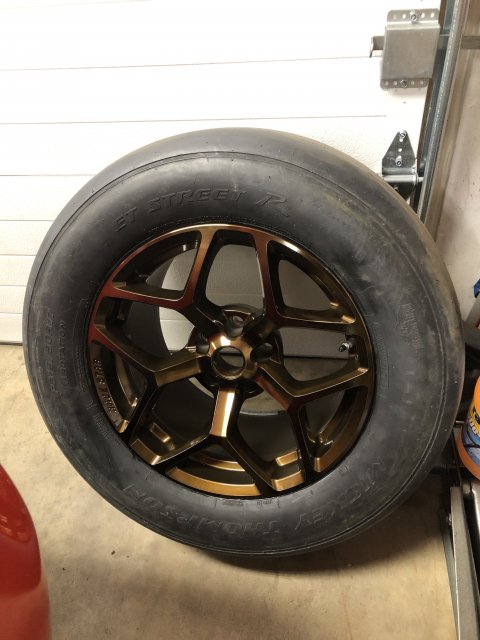

17x10.5” Race Star Recluse with 28 mm back space with MT 315/50-17’s Street R’s. Had to space them out 11mm’s to clear that dam frame bump on front lower side of the wheel well.

These Dorman 610-435 only 8mm longer. Long enough to give me full open ended nut engagement but should still be short enough for when I put the stock 20’s back on without the spacers with the stock lug nuts the nuts shouldn’t bottom out into their heads. If they do I’ll get these longer ones
https://www.amazon.com/DPAccessories-LCB3D8HEOBK04020-Chrysler-Charger-Challenger/dp/B00JNL64KM
Their available in black and chrome
I just bought some open end wheel nuts

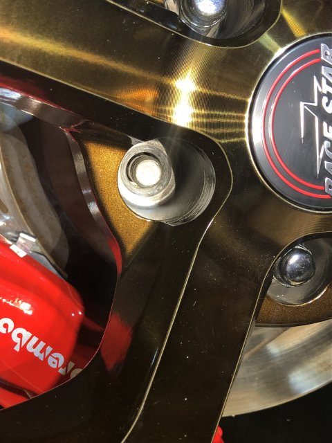

FF7729C9-ABD4-432F-9E1D-50E86FA7C111.jpeg This what mine looks like with stock studs, 11mm spacer, and the new Race Stars, and it’s 45 here today and dry, snow coming tomorrow, I soooooo what to go test these 17’s but not on 6 threads lol. I think it would literally blow the tires off first launch.
View attachment 8673 This what mine looks like with stock studs, 11mm spacer, and the new Race Stars, and it’s 45 here today and dry, snow coming tomorrow, I soooooo what to go test these 17’s but not on 6 threads lol. I think it would literally blow the tires off first launch.
That is the dictionary term for " sketchy" lol
