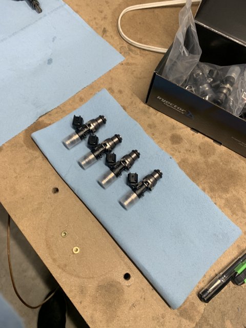

Installed Injector Dynamic 1050X injectors on my hellcat. Wrote a baby tune to just get the idle under control. Right now the car feels as if the power comes in earlier. Seems reasonable as the injector doesn’t have to open as wide or ramp up with power to dispens as much fuel. Looking forward to a track day so I can see the WOT data and adjust accordingly.
The journey to understand the PCM, a tune and a log of the final fuel adjustments can be found here: https://www.hellcatforum.org/thread...r-tuning-for-a-2015-hellcat.7302/#post-129929

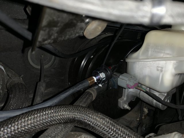

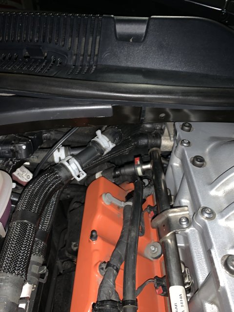

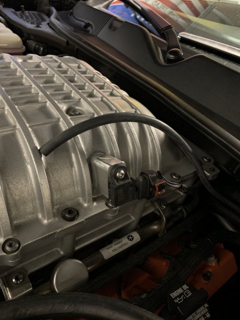

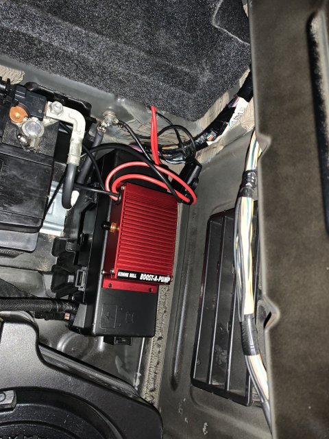

Tonight was a fun night. Rode the striggle bus on this one. Partial Boost A Pump and AAD boost reference adapter.
Ran through the left side of the undercarriage and comes to the top of the engine bay where the fuel lines do (use their heat shield).
Routed to the driver side and zip tied behind the cross member/wiper mounts. On the driver side mounted the reference switch on a line pretty snugly. There have been issues with the reference switch being on the supercharger.
And finally the boost reference adapter

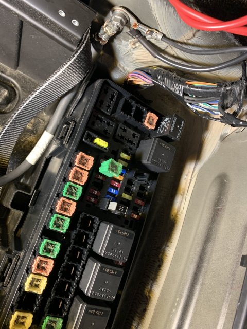

So I say struggle bus because I'm missing the following pieces of information.
1.) What is the thread pitch for the boost reference adapter? I want to head to the hardware store and get the right fitting... I had a thread feeler gauge and the closest I could get was 27 NPT but I don't think that is it. I went to AAD'S website for the product and couldn't find an answer.\
2.) The instructions for the BAP have me all fucked up in the head. It says pull fuse 21 but fuse 21 on a 2015 Hellcat is a spare. Had the notion of rewiring the PDC and said no to that... The 26th fuse is the 30A fuse but it is low profile and cannot utilize the square 40 amp one they sent.
Guess I'll reach out to HHP as they are my crack... I mean parts suppliers :) Hope to wrap this up and get my ass to Cecil on Saturday for some rippems!

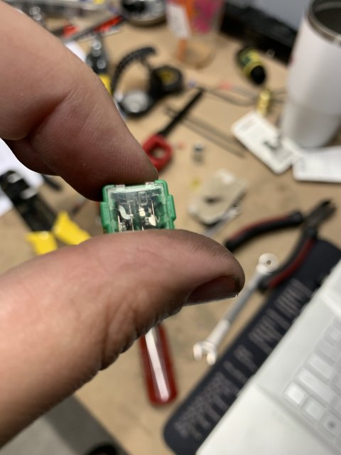

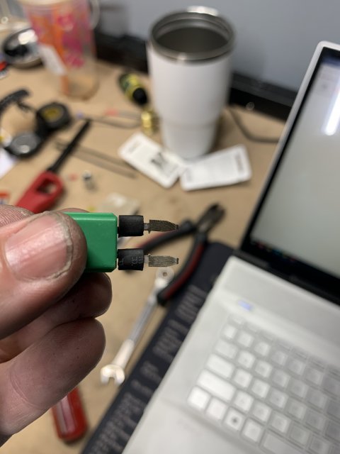

I'm convinced this is either going to be a good day or a bad day... Innocent 40A jcase fuse right...
syke... redneck engineerded the shit out of it

Duuude... what ARE you doing?
...or trying to do?
LOL
Bob
The KB instructions say to remove fuse 21 for the car. On my hellcat 21 is a spare. Fuse 26 is the fuel pump. Unfortunately it is a 30AMP low profile mini fuse. I searched for four hours and at multiple shops for a 40amp low profile mini fuse. No one carries one. KB doesn't supply one and HHP recommended Napa. Napa didn't have shit... This is me modifying the fuse that KB sent me to use the low profile slot, fuse 26.

Sir (said with the most respect I can find at the moment), might it be possible that you've gone down a rabbit hole???
:unsure:
4,134
10,408
:unsure:
It's been a long day. No disrespect taken at all. Why a rabbit hole?
It just seems unlikely that the scenario you've described wouldn't have been dealt with in a more fluid, viable way by those supplying you components? (KB) Any one of those constraints you rattled off, if either a variable, or misread, could send you down a unnecessary path?
An alternate fuse location option for example? (I'm guessing here, not being directly exposed to what you're doing)
I do like the mentality of overcoming the problem however!!! ;)
It just seems so... ...painful...
