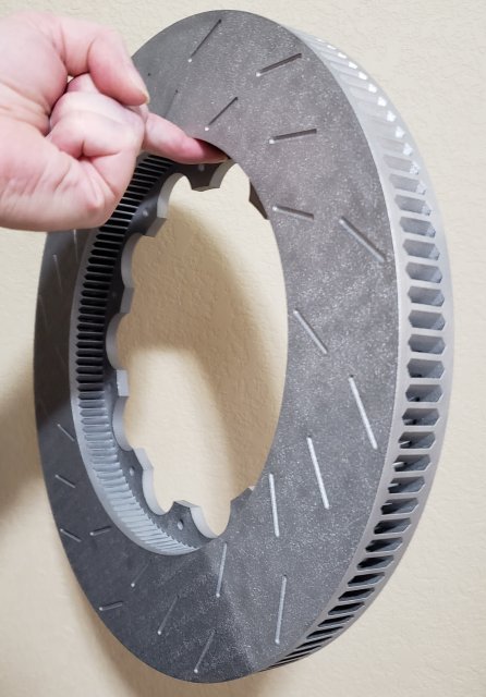

Here's an early prototype, the size and alloy are correct, but the internal matrix is wholly different, this is just a "basic" fin design by comparison. (Think F1) This piece has not been post processed yet either, so the finished part will be a bit lighter than shown.
We're still a ways off yet...
CDT Rotors
#2049
98
322
Frederick
Challenger Hellcat
Yes, that is less than 9lbs hanging off of that finger...
Edit: Actually, I misspoke, it WOULD be less than 9lbs hanging off of that finger, IF you INCLUDED the hat and hardware....

And just in case anybody is wondering, yes, that is the 390 * 34mm front Hellcat rotor.
Are these rotors ok for DD / street & race ?
CDT Rotors
#2049
98
322
Frederick
Challenger Hellcat
We believe that for the typical Hellcat driver that there will not be any issue with DD.
With that said, we have seen Hellcats with rustic wraps, mud tires and literally being driven in the sand off-road. We've seen Charger HCs doing donuts in 12" of snow in elevated parking lots, and even a Demon doing 0-60 videos in the snow as well (much love). So with that said, if this is someone's choice of driving, CDT Rotors might not be the best choice for those owners.
In design there is always give and take, and if CDT gave up something, it was tolerance for exposure to extreme debris.
Look at the vents in the O.E. rotor, you could pass a truck through there. There are two reasons for this, mass and, in our view, a silly need to accept debris that cars like this never (almost) see.
Many Hellcat owners don't let their cars see rain, nevermind mud, gravel, sand or salt.
Our rotors are specifically designed for, and intended for performance driving, whether it be 1320' at a time, or road courses.
When you see the actual design for the first time, we think you'll be impressed and you'll understand.
