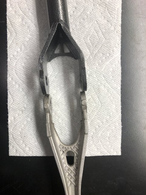

I called BMR on the width issue with the trailing arms, needs a washer on each side then was a perfect fit. I put rubber boots over my rod ends as well but will be removing these links and putting the on car adjustable ones on as they look beefier. 6404417D-FC14-484E-89AB-26DE971EF85D.jpeg 5D9F9EA0-0D5F-44A2-86ED-4A0D0387E9AD.jpeg

A picture is worth a thousand words! Look at that weakass cast aluminum trailing arm. They break! Even had one break on the dyno. Not everybody wants to go to a full drag suspension but if you are modding at all..... that along with the DIRS brace, is one of the things that needs to be done.

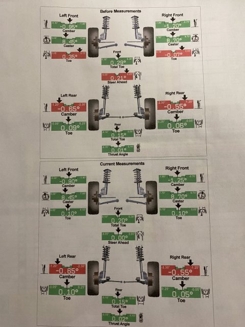

This alignment took adjustable four corners by AAD, plus the BMR rear toe adjustable items. It ran a 3.3 second 0-60 and 11 sec flat on the street with street tires. It don't flipping hop anymore either. It feels out of this world to drive now, big difference from stock.
Interesting. I just put indy 500 305/35/20s on 11" MMR rims my 1320 for daily driving and my rear alignment is nearly identical from FCA to what you put yours at, though the shop told me they couldnt adjust anything in the rear camber without adjustable parts etc etc. Maybe its good they couldnt.

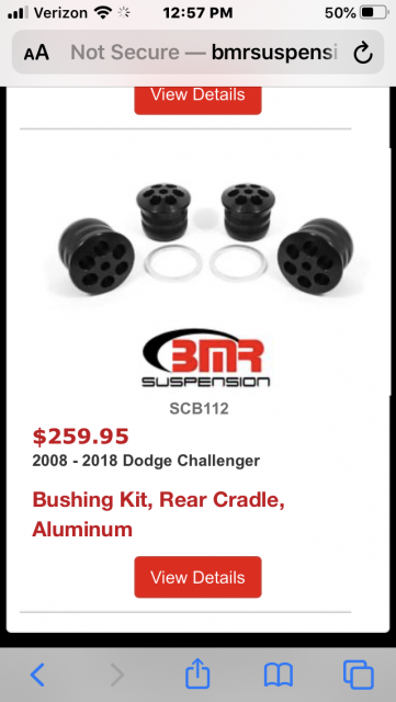

Scb112 is BMR part number For the cradle kit/ lockout kit.
Not that much different. Notice the spec mine has says the rear camber is good up to -0.2 degrees, not -1.2 degrees. Otherwise both of ours are red. The more positive is better for the street/acceleration. I see the guys who race go more positive.

@Hpindy
What cradle lock out kit did you use? Any idea on part number?
I got this one
