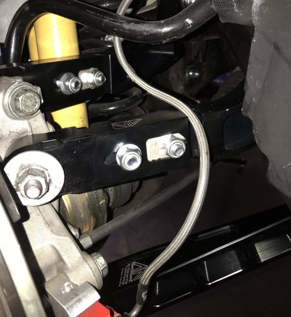

Full tilt rear IRS upgrade for the lapping crowd to help with our apparent handicap there. I have AAD on the top arms, I really like the BMR toe rod. I did NOT like the BMR tension rods yesterday. I replaced another set of arms I had on it. The spindle end of the BMR arm was about 1/8" more wide than the OEM bushing there. WTF BMR, new measurements, or did you not send me some necessary hardware? -uck it, I squeezed it down. If it looks like shit after a session, I will have spares with me and I'll be a bitch! I also have the Whiteline bushings and the big differential brace our brothers on the Forums have made for us. The DP rear two piece rotor is also installed for the viewing pleasure here. No hop any longer, I have even tried to get it to hop, it is really fun to drive with some large meats out back. The NVH on the street is NOT any greater with all the changes!

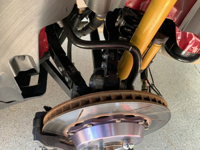

I also have the AAD adjustable arms up front with some other goodies to drive these 325/30's. Bolted on this set yesterday with the change in brakes to track it next weekend. Yes, I will wash the bugs off and give it a nice bath this week. Some alcohol presoak melts them off that wrap on the front bumper.
