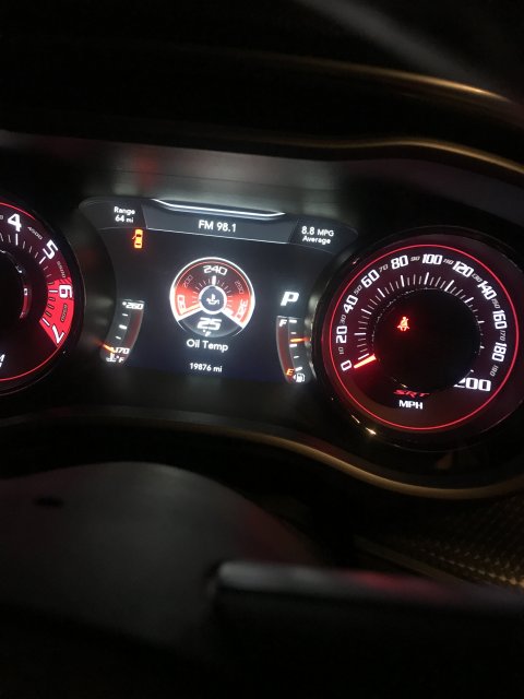

BLKOUT had mentioned the car being hard to start cold in ethanol so I decided to check and see it dropped to 19 degrees yesterday and like he said I started it it ran then died two times
Got home last night it had been sitting all day outside and same results started it two times started died so I decided to use that option that my car came with (block heater) here’s two pics the first is before plugging the heater in and the second was taken this morning when it was 16 degrees out
This more the car started and ran just fine this was before starting the car coolant temo was 70 F4B8EF70-AB63-4361-B434-E2E9E7940602.jpeg 9ED365A9-DB2C-449D-8ABE-A59C4D7636FA.jpeg

All I see is 8MPG LOL
Lol that’s Because it’s been park since Saturday when I drove home from the track , it’s ok speedy one day when your car gets big horsepower you’ll understand :ROFLMAO:
