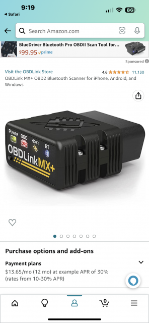

ELM327 interface
Plus 5 for software?
8,435
7,347
ELM327 interface
$50 for softwar (off their website) and get an obdxii
8,435
7,347
Er, obdmx+
