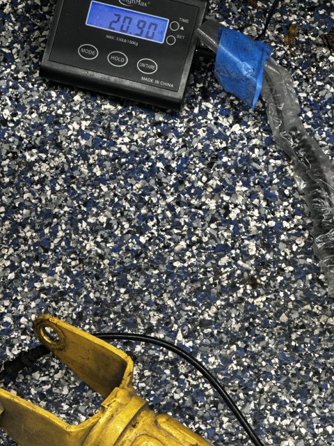

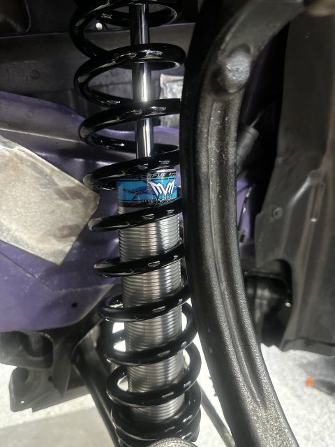

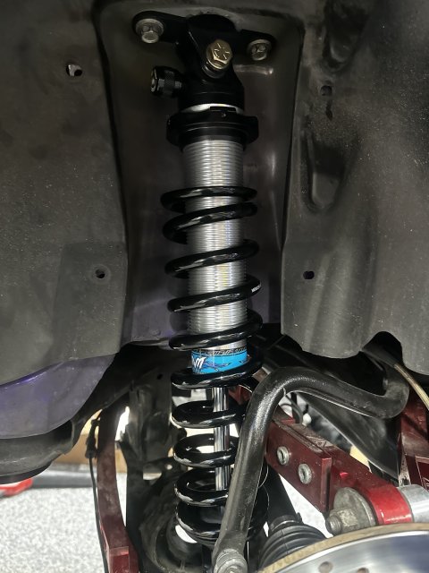

I like! All of the electronics are out of this car right? Wonder if I can disable the active suspension and switch to these
Yes shock delete engineering makes plug In adapters to keep light off
5,066
4,193
Ah no way really? Good to know. Let me know how these work after you dial them in
5,066
4,193

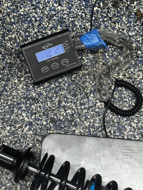

How much total weight did they shave off the car too? You remove the rear perch springs with these right?
Was about 30 pounds total front and rear yes you loose the rear springs. Going to be a bit I’m putting in a cage also and my 3.8 whipple

$600 for the sctiver dampener delete is insane. I wonder if you can just shut it off with Alfa
I could for 4
zhc
7 Second Best E/T
#1019
371
1,281
2016 Dodge Charger Hellcat
Yes you can. I totally forgot that’s what I did on my car once i switched out all for shocks.
