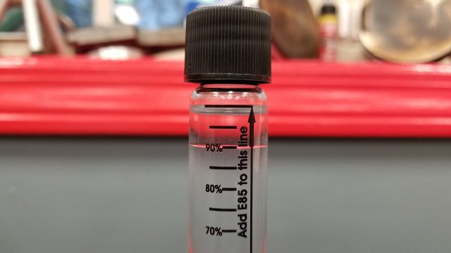

Good corn, not even at the highest it will be yet. Around here it will read above 90% on the test tube once the full "summer blend" hits.
Anything over 80% on the tube is good for 21-22 degrees of timing....

Then this happened @FFBOS
The car picked up the change in less than 90 seconds and reads this as 92-97 % in the log.

Fire corn. I find the test tube to read 5% higher. I’ll do a post here soon when I get a full tank. I had 12 gallons of e70 in the tank. 75 on test tube. Added 6 gallons of e75. 80 on the test tube. Brought me up to 71.7-2% which should be dead on for calculations. I’ll report more.

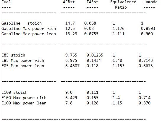

7,559
19,818
Thread Starter #137
This may be useful info for those that like this kinda stuff
coolblue
#1172
1,577
2,695
Excellent! Good reference and quick check chart. Helps put perspective on things, esp since I only speak AFR fluently. Taking a pick to save on phone then a copy and paste on computer. Thanks. (y)
7,559
19,818
Thread Starter #139
Yeah Mike got me away from thinking in terms of AFR last year. Lambda actually makes things a lot more simple.

Just ran a data log in 50 deg F air with measured E90+ that the car reads as 97% ethanol to test the fuel system. Beaker read 95% a couple minutes after filling it while at the pump, and 90% an hour later when I got back to the shop and took a look. I figure this is about a worse case scenario. Anyone know why the reading changes over time?
Car made 17.5psi, 2.20 pratio, 1800-1900 aircharge injectors tickled 85% DC right at the 6500 RPM shift point. Fuel pump DC 78% and 81psi fuel pressure.
A little over head left on these ID1000 injectors but that's all I'd want to see personally.
