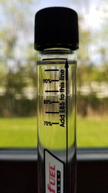

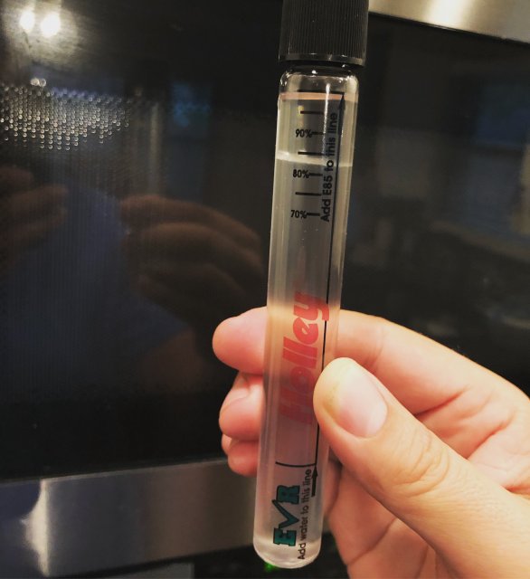

This is from the station right by my house. I just really don’t want to pay for the dual pump

Looks just like mine.
