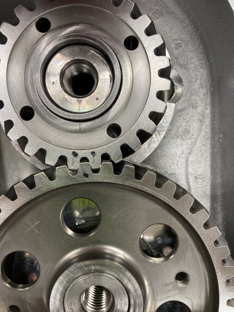

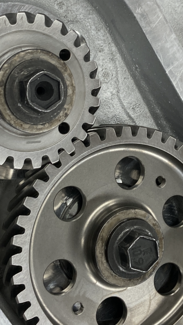

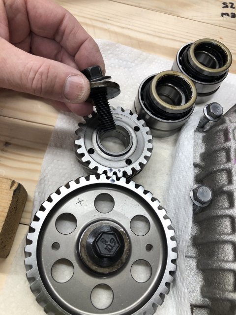

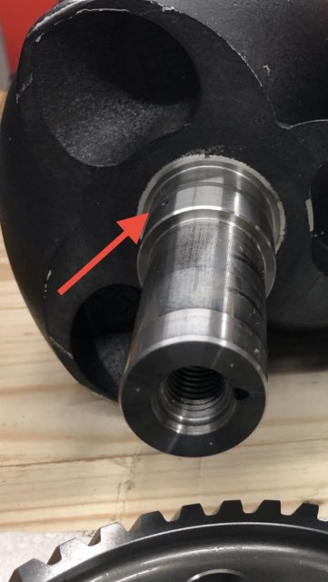

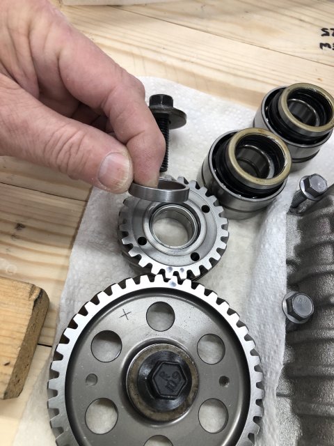

Got the blower disassembled. I think I found what happened to it. These Litens pulleys are supposed to be decoulper, so when you lock the shaft it shouldn't spin clockwise, but SHOULD spin counter clock wise. That's how the decoupler works AFAIK. This one was locked up. Wouldn't back spin. I go to remove the pulley, flip the snout over and the 15mm shaft bolt head literally falls off. It had snapped and this was before I even touched it. My "guess" is that the decoupler or something went bad and somehow caused that bolt to break?
Getting that pulley off was MUCH harder than on my Hellcat. I have a big boy impact, Nitrocat 1150 which as 1295ft/lbs breakaway torque. It wouldn't budge it! I put a heat gun on the front of the pulley for 30 seconds or so and brought it up to 150° F and hit it again and it broke free. Crazy it was that tight. No loctite on threads. That had to be over torqued?

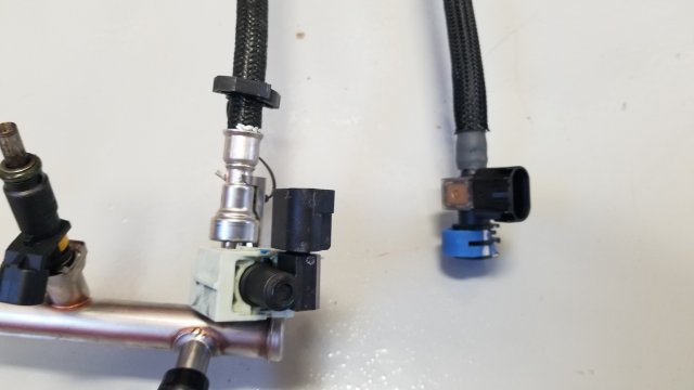

@16GoManGoHC2 I wanna clean up the TMAP sensors. I have some CRC QD electrical cleaner, figure it's G2G on these TMAPs? https://amzn.to/3QVTnxh

I use Mass Airflow cleaner on all sensors.
