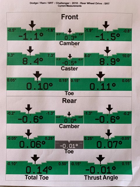

First, how about these factory/street alignment readings?
Damn, to say that is on the nuts is an understatement! Had a great tech and seasoned racer/mechanic that is known for being rather anal. When given the toys from AAD and BMR he got it on for my street pleasure. I can say it drove real straight. I'll talk with him Monday, he also knows which AAD chip makes what amount of angular change for my track use. Plus he knows what the toe settings do when we change the camber only with the arms.

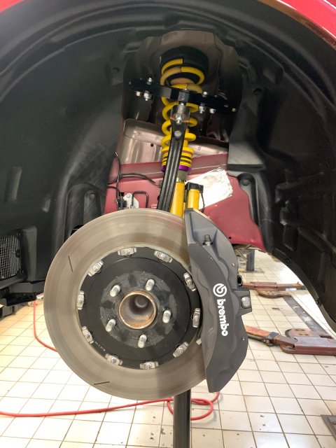

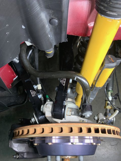

Some car porn...
What you can't see clearly are different tension rods and solid shorter sway links. Did you catch the GyroDisc aka Demon Performance two piece rears, with their air vanes? I had the tech just change them out while he had the rear down on the floor. I only had to drive a short distance home. Yes, it was interesting feeling so much pull from the rear on a "what the hell" big braking moment (has Hawk DTC-70 pads). I still have the Powerstops on the front. I need to just change those out to match the rears to be ready to go. Here is the front, almost ready to rumble.
It was a short 15 mile trip home a couple exit ramps, an attempt to check for wheel hop once all with 30 degrees and with Toyo R888R warm tires. I was real, real happy with the ride. The Redeye has a great street personality. Given the temps and the tires it had on it, it did not seem very different just riding down the street. As was my experience with the same rear mods on my '15, the Whiteline bushings along with just upgraded arms and their more firm bushings, the ride comfort of the car don't feel stiff like other cars it whips on the track. Hell yes, it smartly turned, and the KW springs working with the two big new stabilizers up front have certainly tamed the body lean a great deal! More to come. If they don't close the roads, me and a friend are off to Oklahoma next week to meet Mr. @sad so he can show us his toys and his home track. Bonus is my friend who purchased my '15 is bringing it up, he got some DP brakes, new PS4S 305/35's on those 10.5" light Triumph monoblock rears and the 285/35's on his 9.5" fronts. I gave him a set of DTC-70 pads for all four corners, so he also has the stopping deal covered. That car is hot! We may even see how hot:rolleyes:

Always scary to look at your car in a pile of parts just days before some event.. LOL Nice to see it coming to closure.
Do those suspension components give you more camber control? Looks like it does??
With the vette, it is different of course in the arrangement. Double wishbone all around. The upper control arms are shipped with two washers behind the dog-bone/mounts.... Want more camber? Remove a washer from upper; causes upper control arm to much such that you have more negative camber. Want even more? remove the second washer.
It works pretty well and i'm actually surprised the factory even included something like this for a street car.... BUT it's really limited in it's adjustability.. It's kind of like you get a "little adjustment" in a "normal" mode..... and a similarly small range of adjustment with a "medium" amount of negative camber..... and finally, a bit of adjustment with a "lot" (for street car that is) of negative camber.
I ask about more camber control... because i think you're going to want a little more than what the factory recommends... Since they mostly consider the challenger a drag-type car, i suspect that there's not a second alignment recommendation for road course use? I just can't recall because I never looked for one... And just ran mine at the very limits of factory recommendation - i.e. as much negative camber as can be had with the adjustments.
On the Vette I'm running (by memory) somewhere around -2.5 up front and -2.0 in the rear. Which is somewhere in the middle of a 50/50 track/street car.
The negative camber is really really beneficial in handling and cornering. Under extreme cornering, it's going to allow your tire to run more flat with the pavement and have a much better contact patch.
At the track, you're going to drive on the outside edge of your tires... Hence the negative camber sets things right.
Naturally, it would seem that this would cause weird tire wear... I'm not seeing any... I can show you this weekend! Coming up soon!
I have shakedown trip (in the Vette) this Wednesday... and I think when we're together, 1 day I'll bring the Atom and the other I'll bring the Vette.
