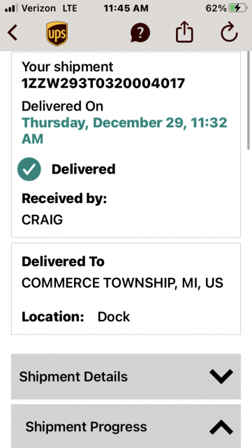

Heads delivered to Thitek today, signed for by tha man himself. I’m told he does a super quick turnaround, 🤞🏻

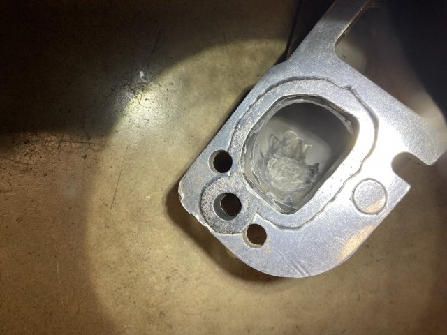

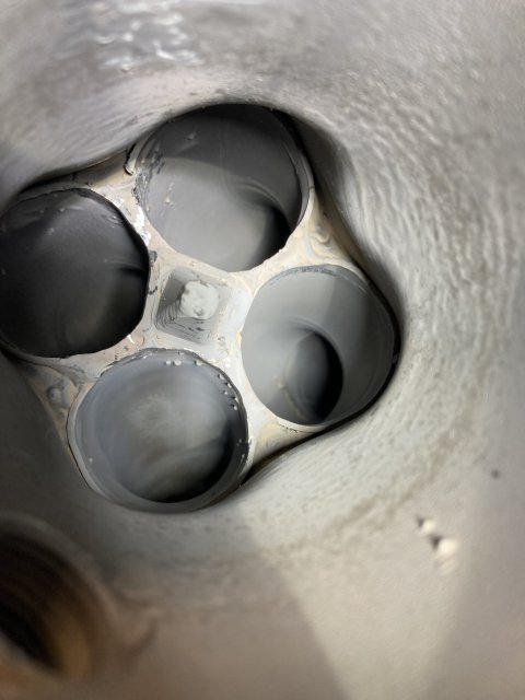

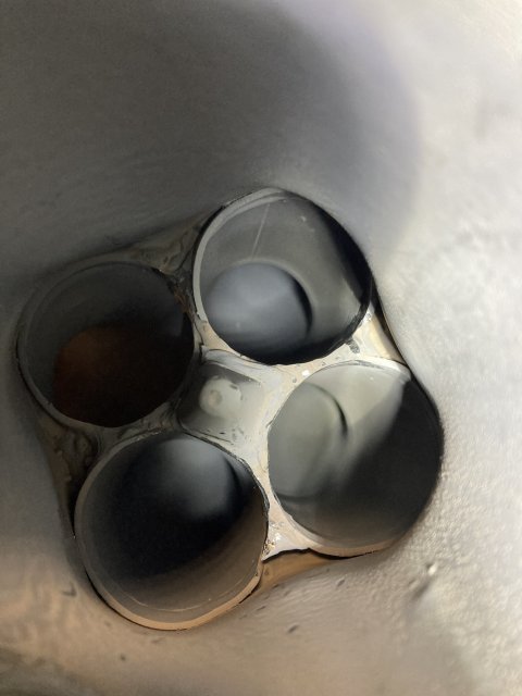

Leaking not needed tube on the header gone. Did ALLOT of clean up in the collector areas and port inlets on them as well, I should’ve taken a picture of the pile of chips that was left it almost filled a dustpan. It was almost 60° here today so I did them outside in the driveway when I got home from work because it makes a horrendous mess inside, stuff flies everywhere.

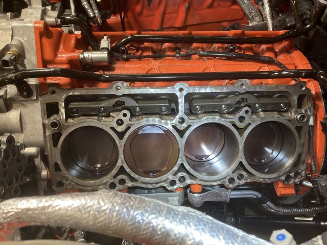

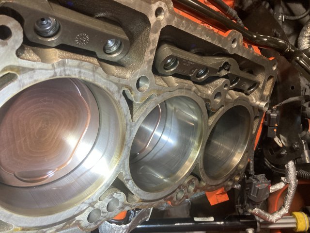

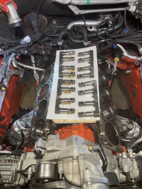

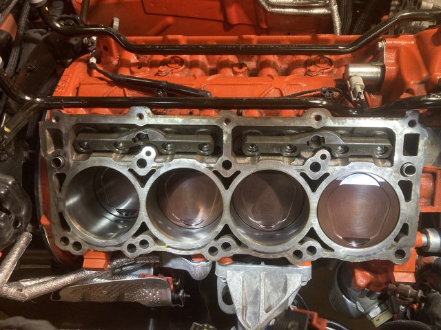

Ready and waiting for the heads, F5AAF370-7CE9-4BFF-BD7C-E660F48F92B0.jpeg 8BCC6915-A2DA-45AF-BB07-A9ACA5E85A31.jpeg 823A3B24-1199-454D-AAF1-8D8480DB9E93.jpeg 5A975616-01B3-48A8-AA4E-5EA940E55B70.jpeg 900FF784-AF5D-438D-A79C-A985F11AB505.jpeg 4EC76BB0-EB39-455A-BCED-6C1814B339D5.jpeg 6814C21A-1630-47C2-A6E4-B70771AABD28.jpeg FBA27D63-5256-4EA2-B3B7-64170BE32CB2.jpeg amazing how running corn keeps things clean. Wiped pistons down with WD40 and they look like new yet 4500 miles later, amazing what hard anodizing type 3 does for anti wear and anti stick properties, that’s what Cephalon non stick cook ware has done to it.

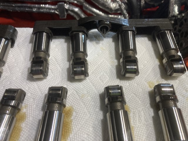

Thread Starter #1,237

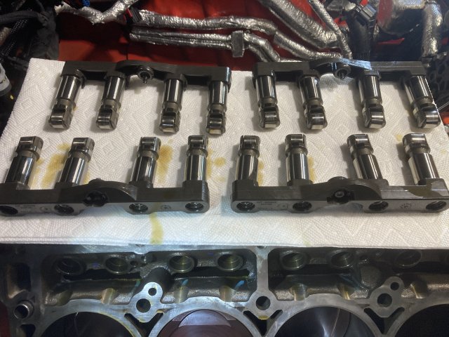

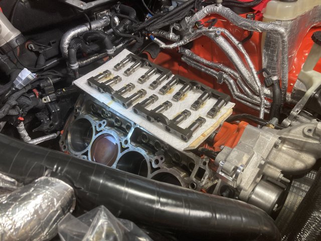

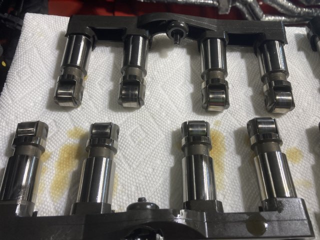

Removed lifter assemblies for inspection as well, all looks and feels good with them. Boy now would sure be the time for a cam change 🤔

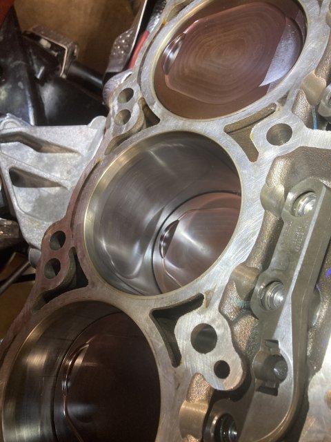

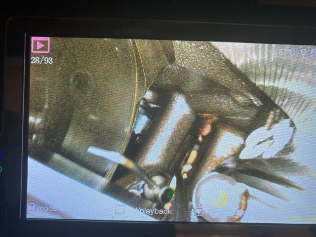

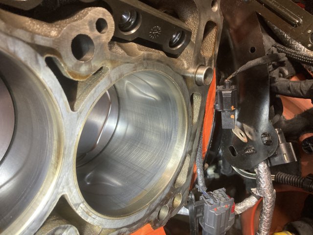

Thread Starter #1,238

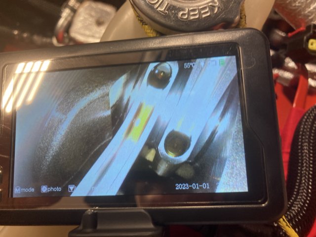

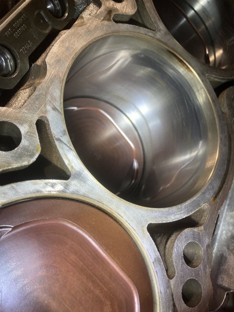

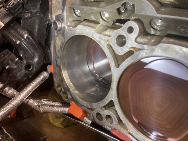

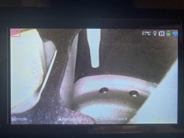

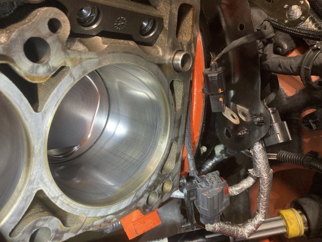

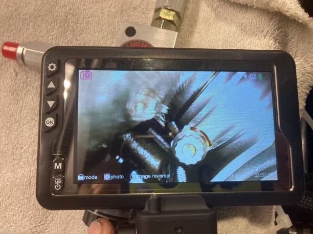

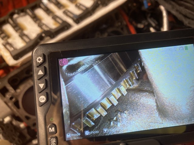

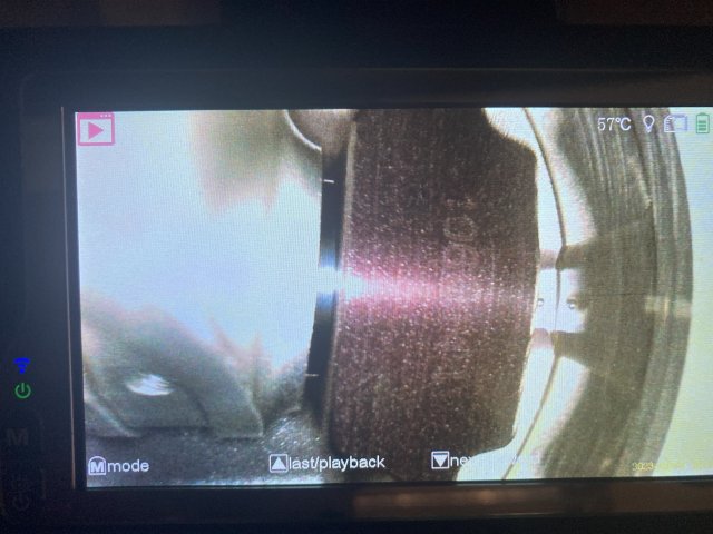

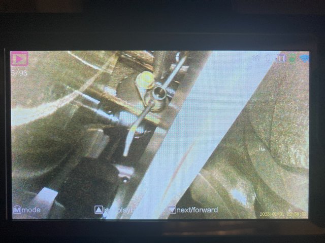

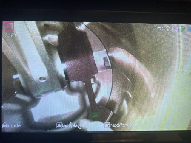

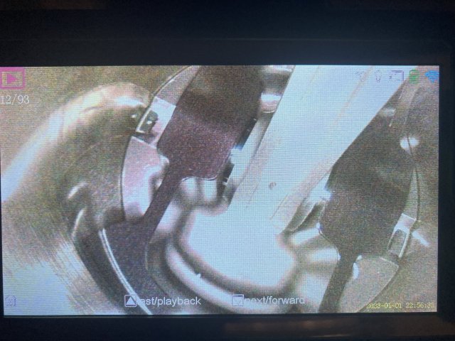

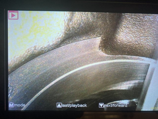

Here’s a tid bit of what can be seen with a half decent bore scope. Underside of pistons anyone? Where do the squirters squirt too? Piston identification? What’s the cam shaft look like from inside? What do the bores look like on the bottom side of the pistons? I inspected every bore, rod connection, wrist pin area (see the black DLC coated pin?), all was able to be gotten too. Was good to see it’s all pretty much like new yet inside.
