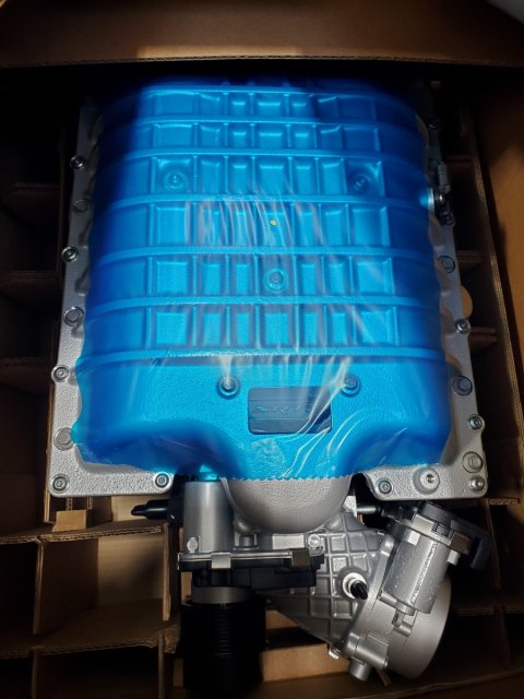

And the Whipple finally returned yesterday!!! Yaaayyyyy. They replaced the complete compressor section and rotors with new parts, basically a new blower. Still a J Rev but they’re calling this one out as a Pinned model, Hmmmm. Did a quick inspection behind sealing it back up, rotors look a bit different and it has a scraping sound when rotated. I’ll post a video on it, sounds much worse in video but it doesn’t turn buttery smooth like a IHI blower does, no rattling at least. I called Whipple today and they told me that is the coating of the rotors rubbing and is normal and will run in and create an almost perfect seal, we shall see but unfortunately won’t know for at least 6-8 weeks till I’m running again :(

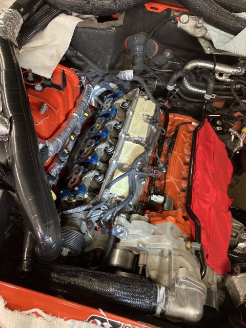

The day I ran that red vett and dark grey Camaro to 180, ie extended full throttle run then ever before since the rebuild and increased boost to 25 psi. I noticed the level in my coolant tank was higher than normal when I got home. When it cooled off coolant level was still about 1/2” higher than normal. I pressurized the system and loosened the set screw in the T stat housing and air came out for a bit till coolant came out and coolant level went back down to normal. Then I noticed it would repeat this if I did a 60-130 pull. Burped, repeat, would only happen if I was on it hard. Sent out 2 oil samples over this process no coolant in the oil. I backed off the timing to 12 degrees no change in coolant level, started inching timing back up a degree at a time and at 17 level rose again and and air pocket in Tstat housing back. Dropped to 16 no air, so in talking to HHP, Satera, and a few other motor guys I know they told me I lifting a head some where. I have an email from Josh at HHP that says over 20 psi of boost they recommend better studs than the standard ARP 8740 studs. A friend of mine that knows AJ well got me this 625 Head stud set at a killer price and I got the MLX gasket set from HHP. Word to note on the MLX gaskets, they have the same oil orfice size in the head gaskets as the 15-17 6.2’s had, .062”(1.5mm), new OEM 6.2 gaskets are .118” (3mm) (The 30% increase in oiling to the valve train comes from this change) So I’m going to split the difference and jet them out to .090”, see if I gain any bottom end oil pressure back or not.
