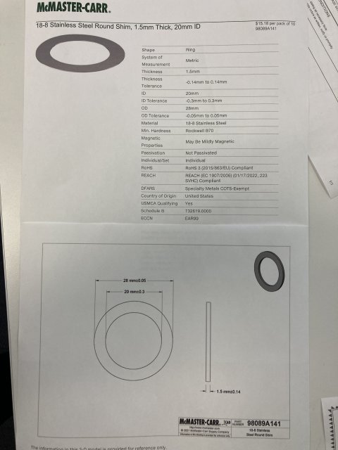

Those spacers for behind Litens pulleys, McMaster #’s below
F5C2E718-3CDA-4A84-884B-B989C2B16B28.jpeg C46D63F5-ED67-4805-93D7-26C2D7902C70.jpeg 5C1924D3-FAA6-45CF-8C10-442CD461E9E9.jpeg
