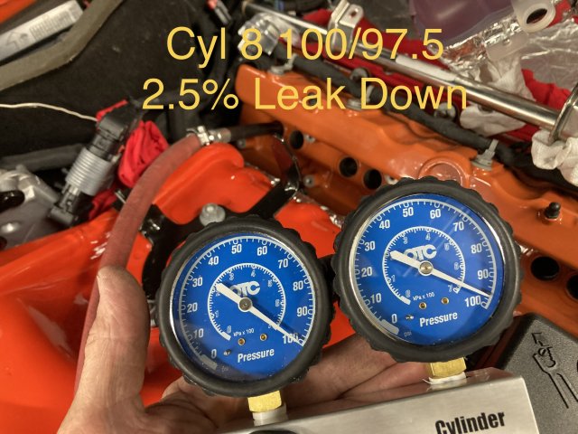

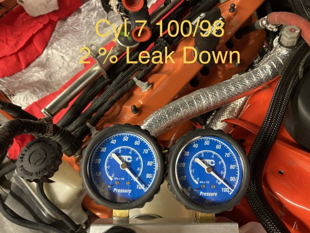

Leak down test says PROCEED :)
Very good for a stone cold engine with big ring gaps. Actually gotten better since the last test 1000 miles ago, I think she’s fully seated in now, 3800 miles since the rebuild.
