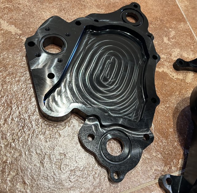

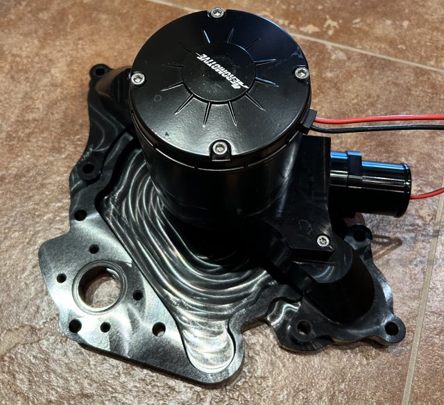

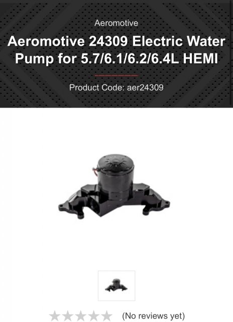

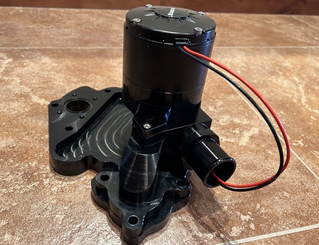

Let’s talk water pumps. This just came out from Aeromotive. A direct mount 50gpm electric pump and plate that is a direct bolt up for the 6.2. Just what serious turbocats needed! 🤩. The aftermarket is catching up big time for us 👊 IMG_7720.jpeg IMG_7719.jpeg IMG_7718.jpeg

Wow, good on Aeromotive! Would have thought Meziere would have struck first - maybe they have - have not looked recently.

This the one HHP has that fits all Gen 3 hemis?
The 6.2 is different. Nothing fits all the Hemi's.
3,630
11,711
Thread Starter #1,686
I don’t see the plate with it, but says it fits all
It’s the plate that is different. The pump is the same but you have to use the 6.2 specific plate.

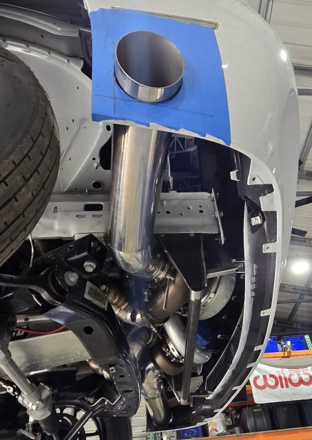

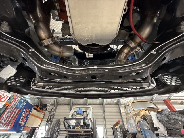

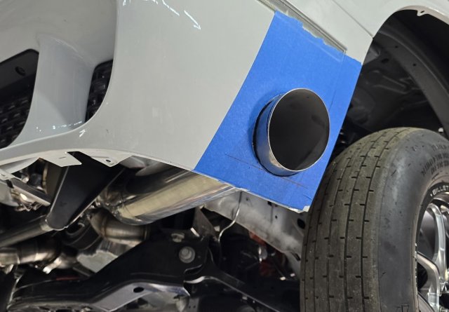

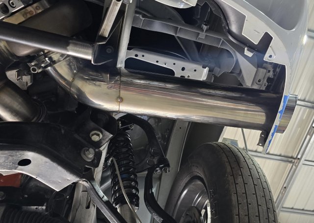

Update on where the noise will be coming from.. 😎 1194425957508635586.jpeg 989115308879963880.jpeg 5200868130246329480.jpeg IMG_8498.jpeg

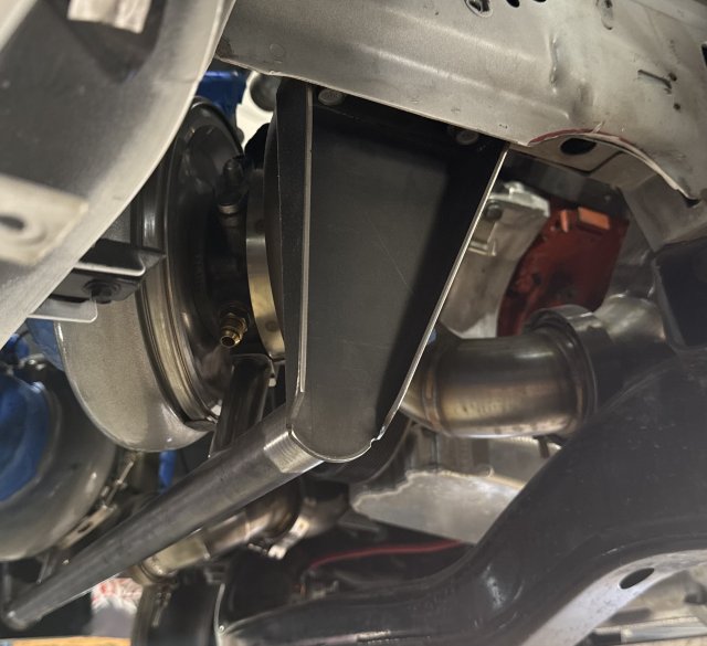

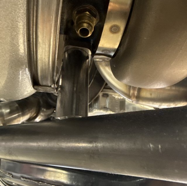

Came up with a nifty bolt-on support for the Maven mounts directly under the turbos. That solidly supports the turbos so there’s no stress on the hot side piping. Just the cold side left and it’s done. 76704789227__931A4F98-E8E3-4E5F-8E66-34C4DA0F8163.jpeg 76704790850__0F6388A5-A613-4EB1-8A15-ED3ECC37F26D.jpeg 76704853500__FB16B17D-F92D-471A-A697-E3BDBD0FCE7E.jpeg

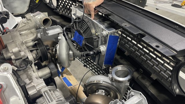

The factory radiator support was replaced with that bar to support the turbos. It will also support the small radiator we will be using. IMG_3460.jpeg

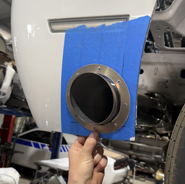

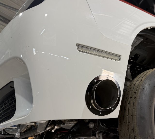

Laid it out with Jason (Carlin Fabrication) yesterday and just like that……. 🤓 IMG_8565.jpeg IMG_8562.jpeg IMG_7807.jpeg
