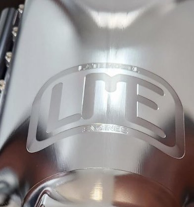

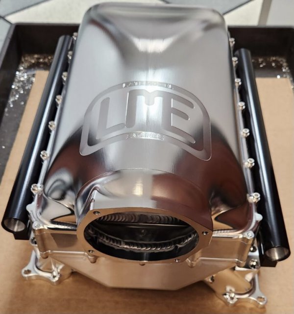

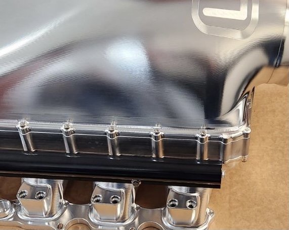

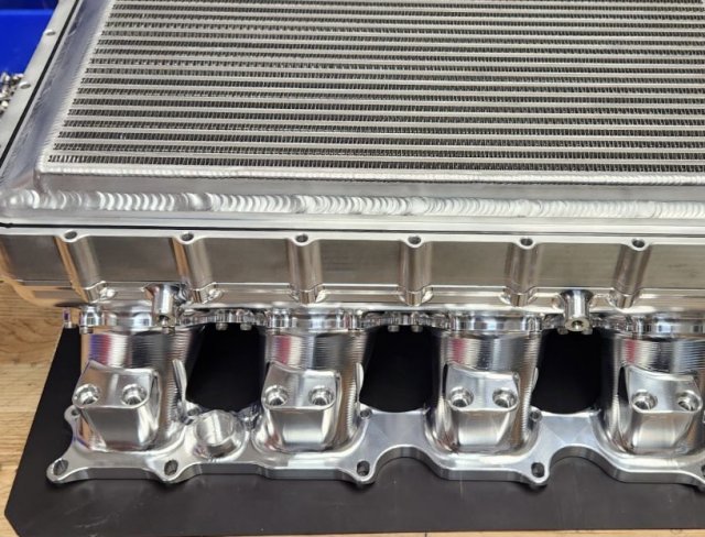

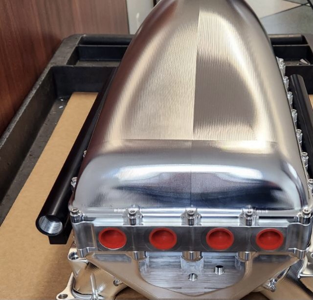

It took a couple weeks due to them needing to CNC the dual injector runners because it’s the first one for a Gen 3 Hemi. The thing is a work of art. I can’t wait to place it on top of that new motor 🤩 9DE0CBE6-CEFC-490F-8B85-912358E281DA.jpeg C6CDCB32-6A49-4E89-95B3-B21612096EA2.jpeg A3929F0A-7DAA-455F-8CF1-1461CE6170C0.jpeg FCDC1023-4F30-4AB4-8C40-C0623EE39A1F.jpeg DAF5E53D-C239-456D-A765-222A88807FF7.jpeg

Nice looking manifold.

The whole point of this one in particular is the dual injector setup that will allow us to start out on ethanol and move to methanol. Even the big 2600cc injectors are not enough to push the TT on ethanol past a point. Let alone Meth. We talked about the big 500 lb Atomizers for the Meth but I question how those would work with the ethanol to start. Anyway… we’re running 2200’s in there now and can just double up on those. Significant cost savings doing that over a expensive set of Atomizers.

That’s a work of art. Wow
