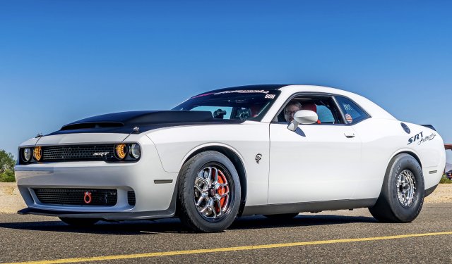

Beeeautiful!

That's like poster quality photo material. Nice! Oh btw your missing 2 exhaust pipes. Lol
Yeah. He forgot to photoshop those back in there.

Beautiful and Puuurrrfect Looking!

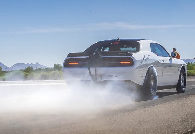

Thread Starter #120
Well.... I kept telling myself that the first time on the track was likely to be disappointing. I figured that the trans wasn’t going to be happy. Yep! It was down right confused. The thing is perfect on the street. In fact better than ever when it comes to partial power shifting. It’s amazing. On the track under full power it was just flat stupid. Off the line she picked up the front and for a fraction of a second I thought ok.... here we go! Then it struck the tires and bounced thru second straight to third where it hazed the tires past the 60’ in 1.57 seconds 🙄 4th and 5th felt good and we hit the 1/8 mile at 117 mph. Then came the shift to 6th at 5100 rpm and the looong run to the finish line. 147mph in 9.61 seconds. We logged that data and sent it to our tuner for some changes but didn’t hear back before the end of the day. They were running classes, so the test and tune crowd (us) got limited time on the track. As discombobulated as that run was, I have to figure a 9.6 wasn’t that bad considering. So.... I’ve made a decision. I’m back home now with the car in the garage and I’ll probably hit the night time T&T’s at Vegas once or twice. But.... realistically not being able to spend all day on a track with my tuner getting it figured out, I have decided to just go with the T400 and save myself the aggravation. I know there are a select few who are successfully massaging that damn transmission nanny in to cooperating. I say give her the boot and go to a manual shifter. That’ll be more fun anyway. There was a Hellcat there that had one and I got the chance to talk with him. It was a A8 conversion. So..... it works and now I know where to start.
