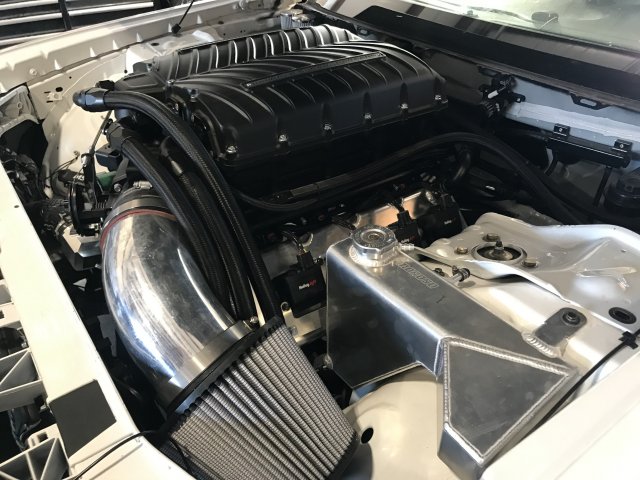

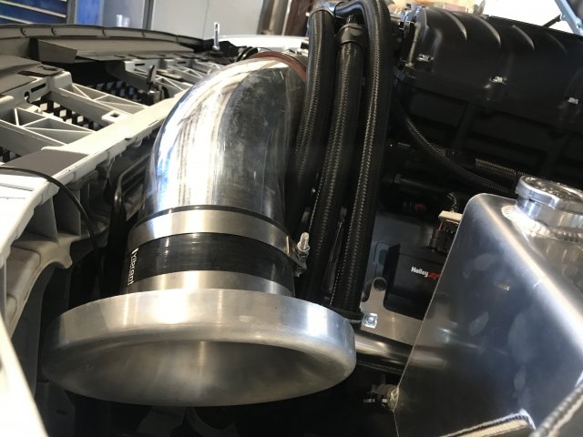

One of the things it told me is that air filter I got off Amazon looked good but didn’t breathe for shit…. or that velocity stack (were calling it the tornado) is magical 😂. 498B22D1-5DEF-486C-8E65-863AA8BBC81F.jpeg 77D186AB-411D-4CFF-A31D-DD51ECE30B0D.jpeg

Yeah, the worst thing you can do to a PD blower is put anything in front of the throttle body, lol.

One of the things it told me is that air filter I got off Amazon looked good but didn’t breathe for shit…. or that velocity stack (were calling it the tornado) is magical 😂. View attachment 85059 View attachment 85060
Someone this summer was telling me about someone making those and how they picked up power on everything

I think that other filter was very restrictive. I have an afe and cannot use that velocity device. Mine is about 7 inches in diameter vs. 5 on the velocity stack.

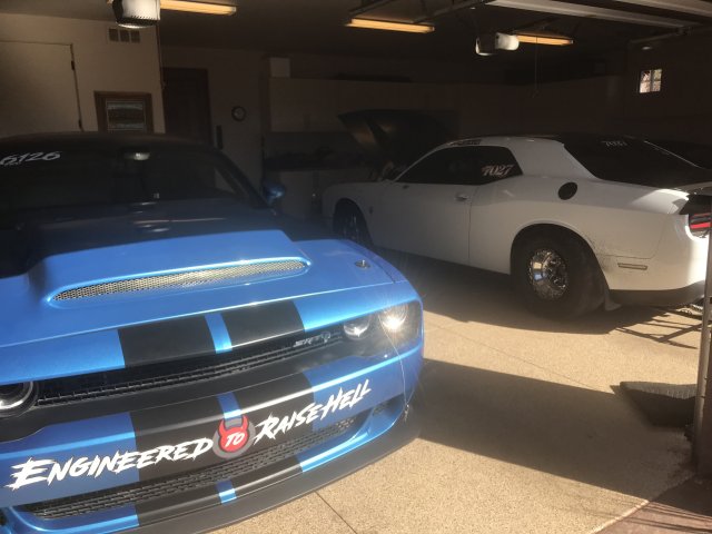

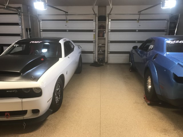

Fairly cool garage now 😜 B534248B-777D-44CE-B87F-A8A8D09D5E31.jpeg CA70DE61-9A28-45E3-B05D-B9D50E5AAFA9.jpeg FAAA8FCB-E321-4C23-9943-1C88AFB98188.jpeg
18,763
98,859

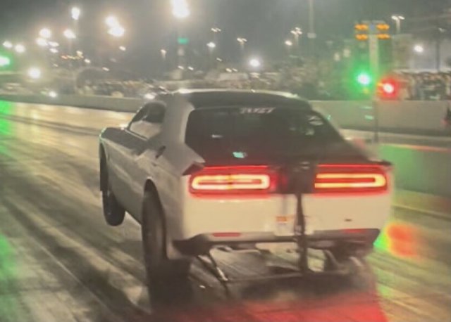

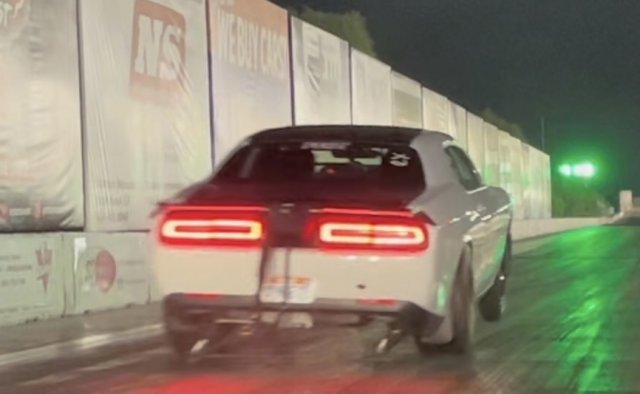

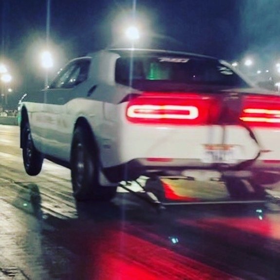

Now the adjustments and track tuning start. We’re going to be using some select sensors that work with the Holley Dominator to make the power adjustments necessary to get it down the track. That and suspension tuning. Both of these are areas where we don’t have the necessary expertise to just do it. We’ll need to go outside and Adam says he knows some guys. 😂. First good example is the rear suspension. Pictures are worth 1k words. What do you see? C724E8F5-BB3D-4844-B8B3-64EF2BBDC0D3.jpeg 9940718A-98F9-4173-9225-189CA2DBED76.jpeg
Tuckerracing
#2718
330
872
Whitehouse
Now the adjustments and track tuning start. We’re going to be using some select sensors that work with the Holley Dominator to make the power adjustments necessary to get it down the track. That and suspension tuning. Both of these are areas where we don’t have the necessary expertise to just do it. We’ll need to go outside and Adam says he knows some guys. 😂. First good example is the rear suspension. Pictures are worth 1k words. What do you see? View attachment 85329 View attachment 85330
Car looks like it is loading the right rear on the hit.
3,631
11,716
Thread Starter #1,180
Good eye 🫣. What it’s actually doing is loading the left harder than the right. That is the anti-squat action where the 4-link is lifting the weight of the car and loading the tire. The separation you see over the left rear is missing on the right. That’s all suspension adjustment. We need to put the car on scales and start making loading adjustments to the track bar and probably some shock settings to correct that. What you see was making the car go right when the wheels were up. Not helpful 😒
