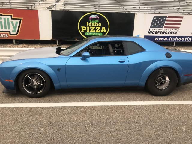

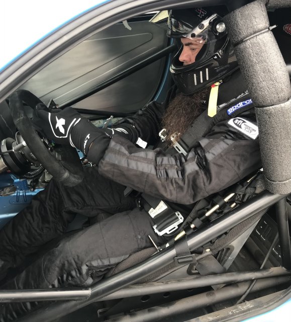

Well, in conclusion…. What a blast! This 60 year old track is the best I’ve ever been to. This was their 50th night fire event. The facility and the people running it are the friendliest and best organized I’ve ever seen. I’m going to guess the car count was close to 600 and the event was flawless. The heavy hitters in the 60’s era fuel cars were there, and watching a fuel altered run 270mph at night standing 50’ from the finish line was just a blast! Anyway…. had a return of the throttle body gremlins Sunday morning and decided to pack it up. I have no doubt that they will get it sorted out but I think I’m glad it’s not my car that will be going through the beta stage of doing it. Just in case anybody is wondering…. this car is (was) a 2019 Redeye. Now she weighs 3670 pounds. 090B036D-D27C-46A6-963F-5312F62E9D9A.jpeg 713EA5E2-6349-4930-8DD1-C80984AE0DD3.jpeg 94ABD2E2-D7D1-45B1-87DB-79D1AA806256.jpeg CAA84A7D-0836-4A96-A45B-C4B7FDFCDAC2.jpeg

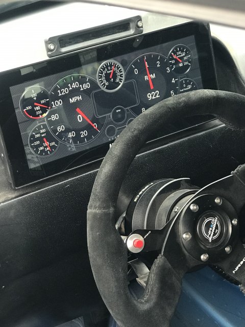

I like that dash !

I like that dash !
That's the Holley digital dash. Very cool!! You can barely see it but there is a programable light bar that is a series of lights that go across the top of the screen. Green to start, then yellow and then red. That can be set as a shift light where the whole screen lights up at the selected shift point. Mine is being installed in the center stack because I'm keeping my stock dash unlike this car.
Will you stock dash be just for show or will anything work on it ?
At this point just for show so the inside is still recognizable as a Hellcat. I don’t like the looks of the fiberglass replacement dash. The digital dash will just be replacing the U-Connect screen. I’m keeping the interior panels and everything except the headliner. That has to go to get rid of the sunroof and make room for the cage additions. I’ll be keeping my old school tach and shift light because I like it.

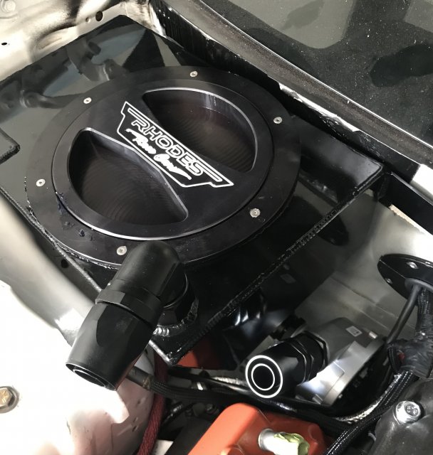

Sneak peek 🤓. New icebox in the making. 39A4A00B-68B1-4429-92AA-F536AAB4F68A.jpeg
Was that custom made for you or is it from a dragpack?
3,629
11,708
Thread Starter #911
Custom made from scratch. You can see that it is yet to be welded. The Dragpaks are placed in front of the wheel where the brake lines are. I didn’t want to completely relocate all the brake lines and the spot behind the wheel actually has more room with the hvac filter and computers gone. Guessing but it looks like this will be 2.5 to 3 gallons.

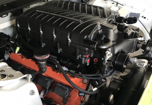

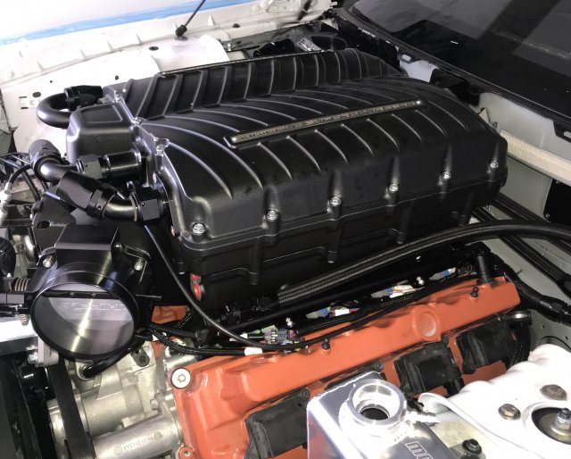

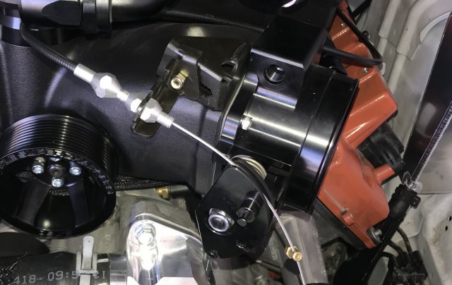

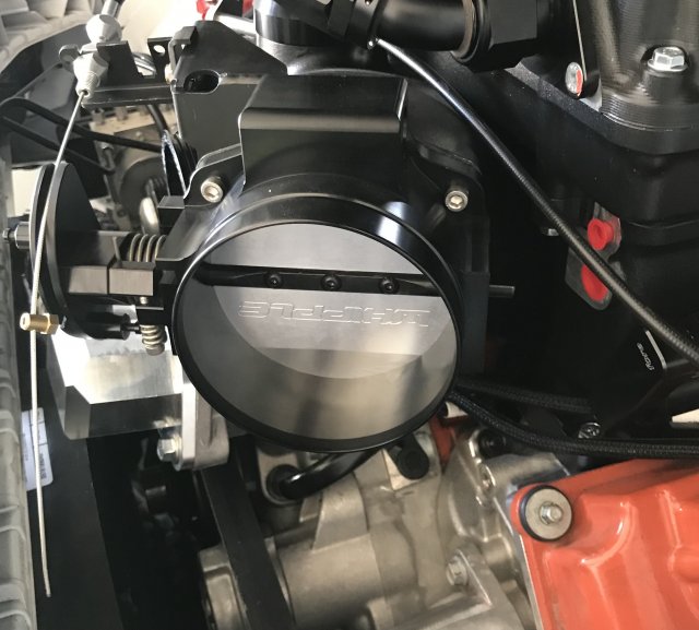

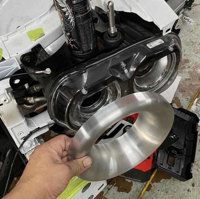

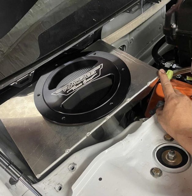

It’s been a while. Finally some progress. 😑 B447EE52-7F96-496F-8BC8-54438D99D3B4.jpeg 98F29281-FE34-4AC4-97B5-2E4236CFA16D.jpeg 301511D8-E8E9-46F5-92BA-868EFAAA9620.jpeg 5868512A-C3F8-4BCB-A065-CE2DE32E5C1F.jpeg A9AE6047-96C6-4853-B8C4-22D392A0CCEE.jpeg 73E34B94-BB1C-4D98-97C3-D69D4A3E5038.jpeg B053AAE5-26E6-4292-BF90-4C327C21526E.jpeg

Hey Marc
Any pics of the intake system you will be using? Or is the velocity stack gonna be on it permanently?

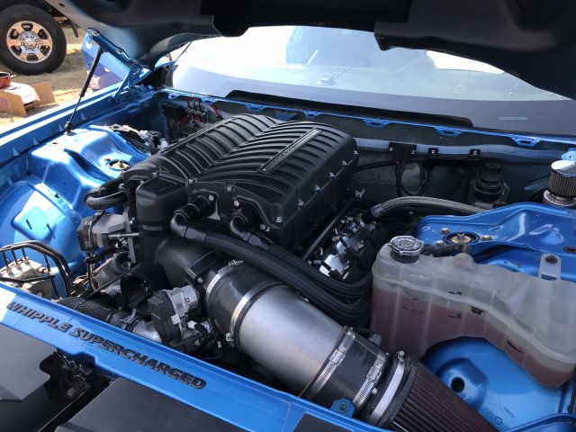

Looks great man. I think it looks 10 times better than the 4.5 Whipple. 👍
3,629
11,708
Thread Starter #917
Hey Marc
I’m in the chassis shop for the next three days in Calif getting the cage done and recertified. I’ll have a chance to get that stuff out and put together. I’ll get some more pics.

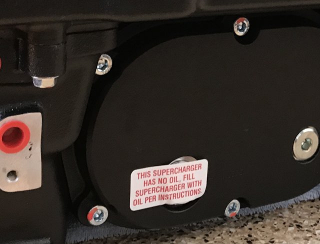

Does that supercharger have the Oil fill opening ?
3,629
11,708
Thread Starter #919
Sorry I meant for the engine oil. The 5.7/ 6.4 have engine oil fill tubes in the intake and the hellcat the tube is in the valve cover .
