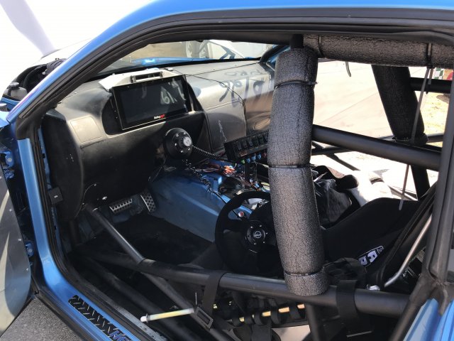

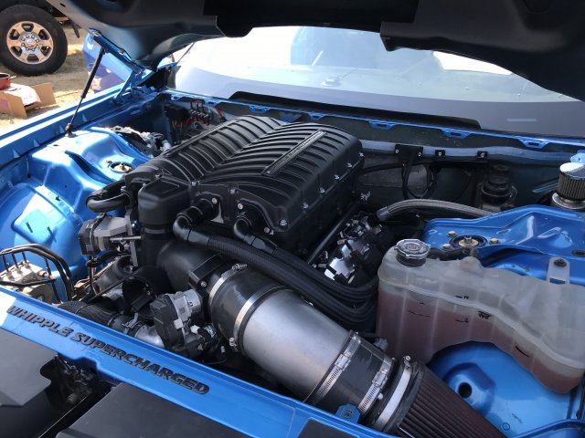

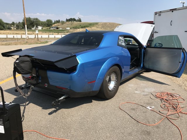

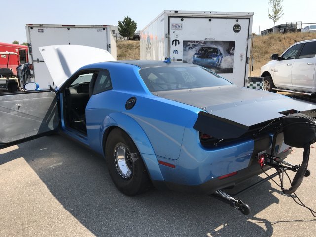

It takes a village of shops. I’m at the annual Nightfire Drags in Boise Idaho. Nostalgia Nitro and hundreds of the hottest drag car in the west. I feel like I’m back in the 60’s! I’m also here with another one of the Western Hellpaks in progress. Getting some shakedown runs on Brian’s Spankintime Redeye. We’re here through Sunday. 🤗🤗 9D14751E-5067-4DAA-A500-153BAF79B061.jpeg 2D85E678-F4B4-4D65-9BEB-91DC8700DBAA.jpeg 87265651-CF45-4D41-8728-26028A6CBD79.jpeg 04513B63-B149-4E89-8809-607CB1EDC774.jpeg
It takes a village of shops. I’m at the annual Nightfire Drags in Boise Idaho. Nostalgia Nitro and hundreds of the hottest drag car in the west. I feel like I’m back in the 60’s! I’m also here with another one of the Western Hellpaks in progress. Getting some shakedown runs on Brian’s Spankintime Redeye. We’re here through Sunday. View attachment 50790 View attachment 50791 View attachment 50792 View attachment 50793

How did the shakedowns go?
3,569
11,489
Thread Starter #894
DA was 6000’ at 95 degrees. Only running a 13 lb pulley and conservative tune due to first time out. Ran 9.3 at 149. Changing pulley now and getting a little more aggressive with the timing. Factory FSS CobraJet ran a 8.95 at 152 as a comparison.
