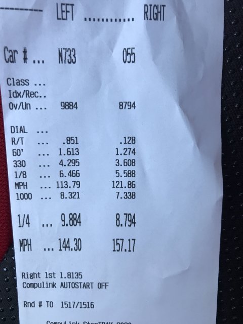

First pass off the trailer.
18,768
98,881
Awesome! Killer 60'. Hope you'll have some video to post later.
