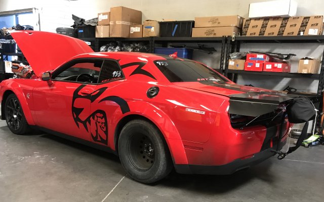

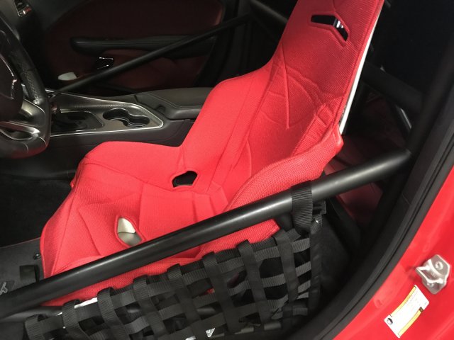

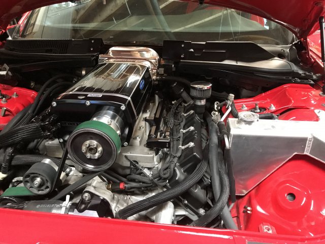

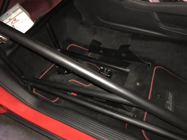

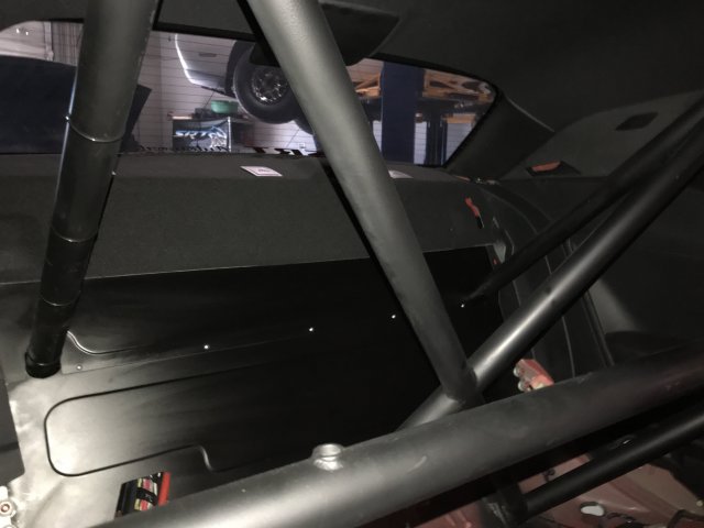

1100 mile round trip to Calif and then over to Phoenix to bring the new project car to the shop. It’s starting to take shape! DB7AE370-0D7B-4512-B4B4-4BF1DE25ACE5.jpeg 1F20E02E-B9E8-470B-AC64-94AC89A1590F.jpeg 93AC2C75-692F-446A-9F2C-165DFC8CB01A.jpeg 8DD173C9-026F-47A5-BD0A-3BEB50B741A5.jpeg 21CFAF8B-FA8D-4FBC-AE73-357FD9B41A84.jpeg

Why the change in head studs?

He put in the big boy 625 head bolts and studs in.
I will let Marc clarify the reason why he did. Another good insurance part to protect the engine at his power level.

Just a upgrade to the ultimate in preparation for more hp. Don’t want to risk a expensive motor by lifting a cylinder head. Trying to stay one step ahead.

That cage looks different because it is. It’s basically a 7.5 cert without the added “funny car” hoop. It’s a 7.5 “prep”. The reason for doing that is to give the 4-link the necessary support to work at high power levels without bending the stock body all to hell. Everything gets ‘triangulated’. This car will end up a seven second ride but there’s a lot learning and experience to be acquired leading up to that. The owner/driver will be best served sneaking up on it. When that time comes, the additional bars will be a easy addition as all the hard stuff is done.

Haha. You better be sitting down. We’ve been discussing the future power plans with some people and one night I got a call at home from my engine builder. I’ll just say he expressed concern and a talk about cylinder head studs ensued. I didn’t sleep well that night... 😳

You’re good. I’m already making 1450 at the crank and the standard ARP package has served me well. The stock heads are more vulnerable than the Thiteks though and boost isn’t cylinder pressure so use your best judgment... 🤑🤑🤑
