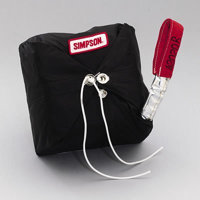

Well folks the party just got real ......
Get ready for shock and awe!
