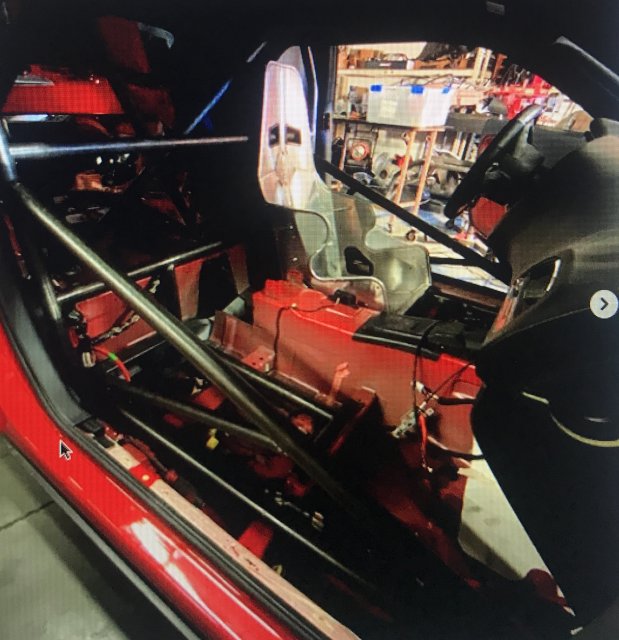

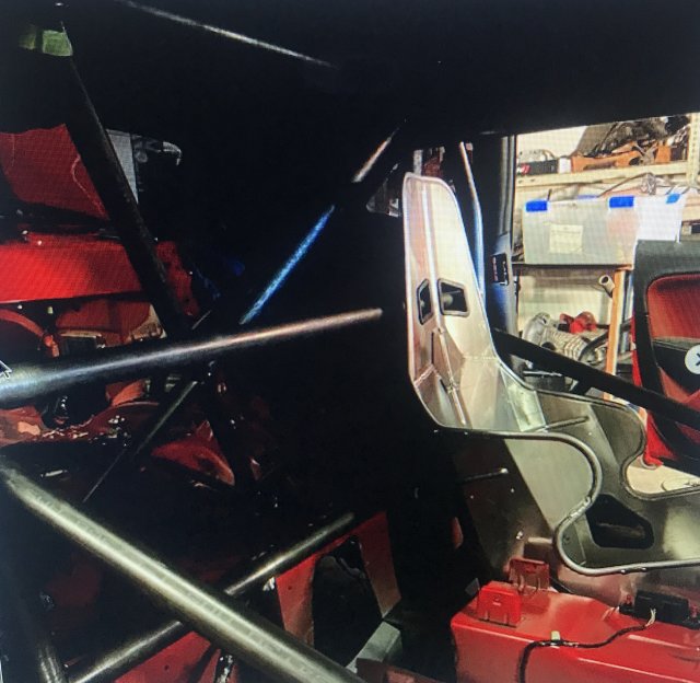

You get the first look at the start of the 7.5 cert cage to go with in my friends car. Look at those bars. They tie into the 4-link in the floor. It’s what keeps that thing from ripping itself out of the car. There’s only one way to do this. RIGHT! B5B3C656-05AE-4D3C-A226-82170BA826B5.jpeg 07E92FD1-F2ED-440F-85AC-A5B93CD8797C.jpeg

You get the first look at the start of the 7.5 cert cage to go with in my friends car. Look at those bars. They tie into the 4-link in the floor. It’s what keeps that thing from ripping itself out of the car. There’s only one way to do this. RIGHT! View attachment 25759 View attachment 25760
I agree with this . Most people think a roll cage is just in case you roll the car over . Lol a well planned cage ties everything together and gets that power to the ground instead of makin pretzels out of the car . It's crazy when you first look in a car and see it but once you start following the bars to there mounting points it starts to make sense .
Btw that seat looks comfy
