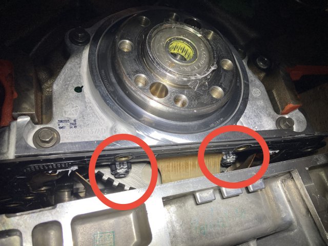

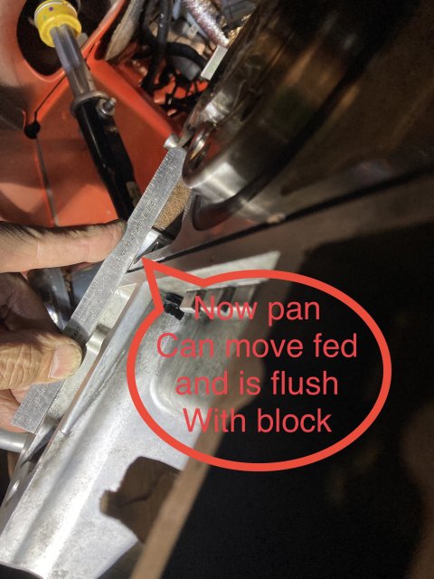

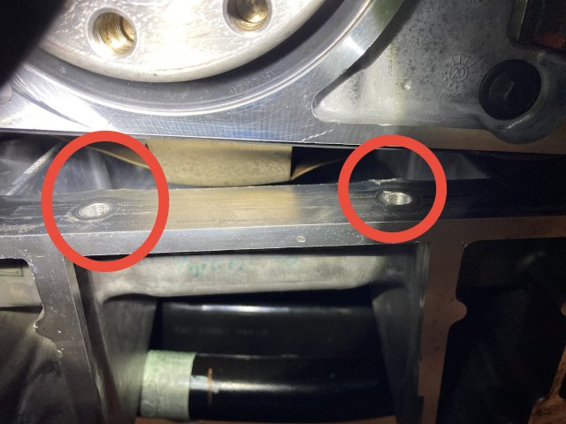

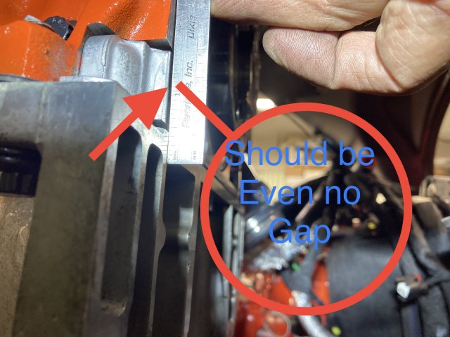

If it was tightened down and then the transmission bolted to it you’re probably not going to see any rub marks on the nuts themselves, you’ll have to use a straight edge on the back of the block and check everything to be sure it’s all flush, the back of the block, the rear main seal, and the oil pan should all be flush
I understand. I’ll look for that before pulling the stock pan off and make sure there aren’t any issues with the new one going on. That will be this. Thanks. D61E522E-EDEC-4C4F-BF75-9F386A5B70B1.jpeg

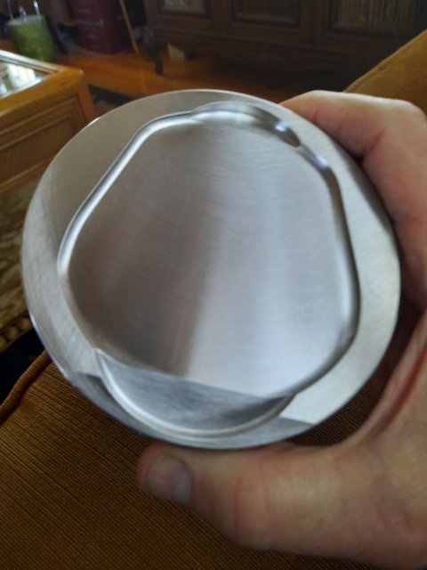

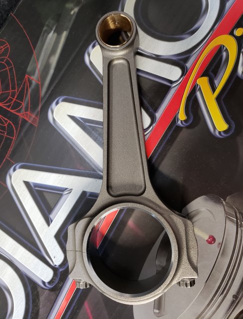

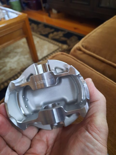

showed up today, 4.100 wiseco 9.75 to 1, molnar crank an rods, 411 stroker.
off to machine shop tomorrow.

NICE!! Same dish shape as mine. What kind of rings you going to use with them? Curious on Pin as well, Weisco supplied?

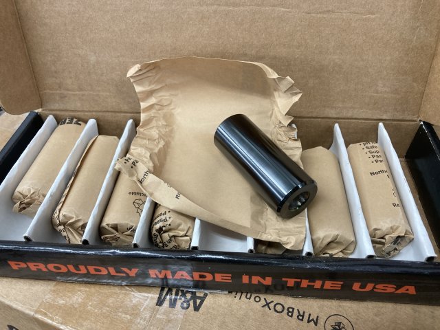

wiseco supplied total seal rings an their own brand pins, size .927 according to wiseco good up to 1500 horse. this engine will never see that much.
I just didn`t want to blow up stock config an now there`s room for a little more power.
hope to run a low 9 bordering on an 8 this fall.
chasing @Hpindy an @DemonSRT gets expensive LOL.
