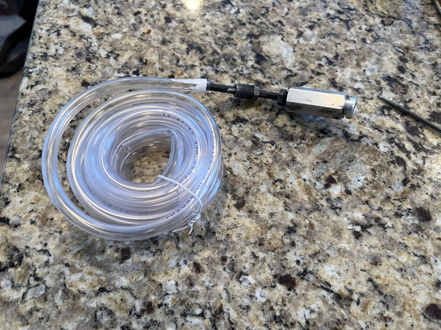

Alright, removed them from the new bearing assembly.
And I lied about the old bearing, the O ring was in there.
I removed the hydraulic stem off the old bearing and attached a piece of tubing. I’m going to hook this back up, then use it as the contraption to flush the hydraulic line from the brake master cylinder with new fluid.

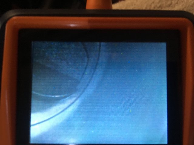

Maybe I'll put it up on the Quickjack this weekend and see what I can see with a borescope???
I don't recall, is there an adequate inspection hole on this trans???

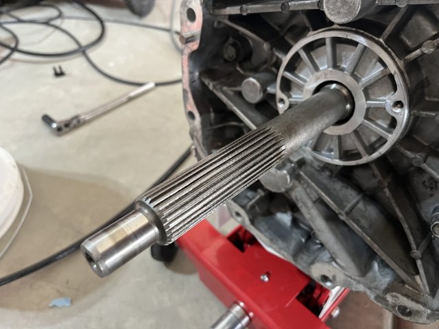

Got the trans installed today. Cleaned up the input shaft, did a bench bleed of the clutch release bearing then installed it, then cleaned out the splines of the clutch disk hubs the best I could with a pick to get the larger chunks off and then a tooth brush with some brake parts cleaner on it to get some of the residue.
The pilot bearing didn’t have any evidence of grease on it, so I used a long screwdriver with some bearing grease on the end to put some in the bearing. Then I applied a little bit of bearing grease to the end of the input shaft as well.
Just cleaning the crap off the input shaft made it 100x smoother, then I applied some of the molykote grease to the shaft and clutch disk hubs and wiped almost as much as I could back off, leaving just a thin coating of it on the shaft.
I’ll put the driveshaft on tomorrow, along with the exhaust, and see how it goes.

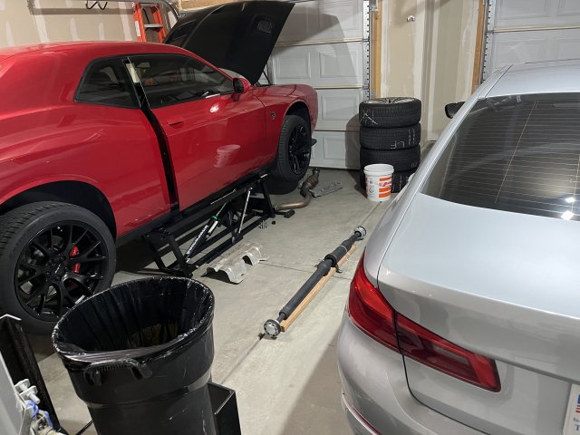

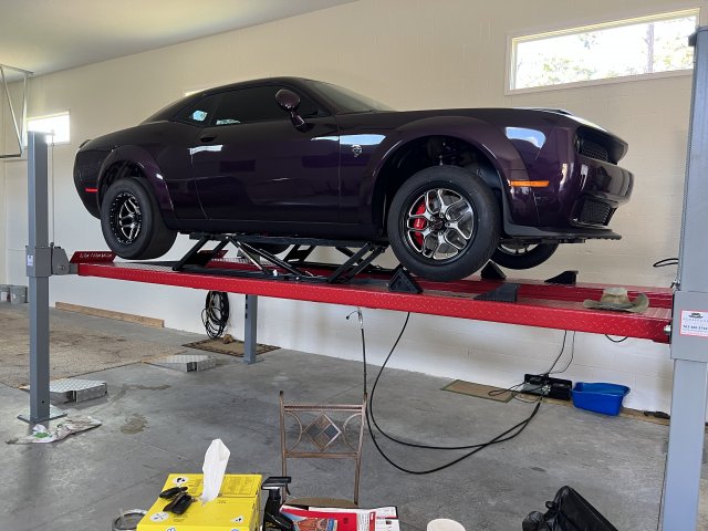

Yeah, would’ve been a little more comfortable doing it that way. @Deano was generous enough to offer up his space and lift for me to do this job (we live just a few miles from each other) but I chose the convenience of working on it at home.
Not so bad but lots of getting under the car, then getting out, then getting back under, haha. Good exercise I suppose. I have a third garage bay that is out of the way, so the car can just stay up on the jack for as long as I’d like without interfering with daily life.

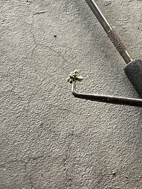

Also, this is what I was picking out of the area between the pilot bearing and the back of the engine block. I imagine they greased it at assembly, stabbed the trans and pushed most of the grease forward and out of the bearing or clutch disk hubs.
This was just gunked up forward of the pilot bearing and this is exactly how it looked inside, I just stabbed it with the pic and it came out as one piece.

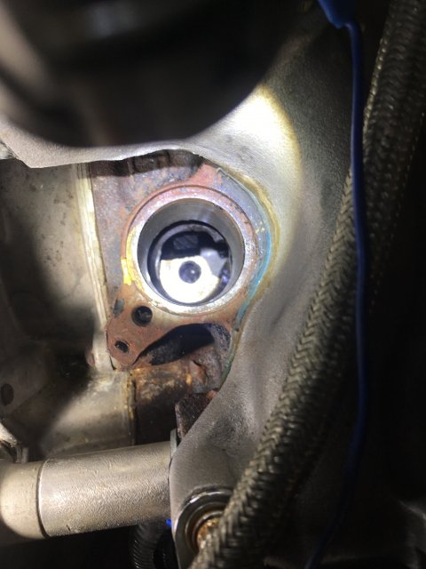

There is about 1/8” gap between the pilot bearing and the engine block though and that is where the clumped up grease on the pick was hanging out. I was able to see it with a flashlight and it came right out once I stabbed it with the pick.

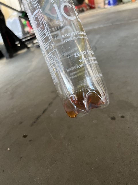

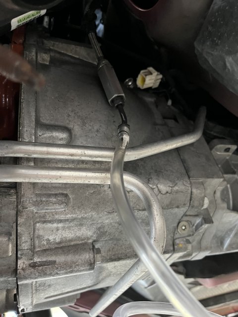

So here’s the contraption I made to bleed the clutch line and get the old fluid out. Took the stem off the old bearing and connected up to the hydraulic line from the master cylinder.
Hooked up the pressure bleed with new brake fluid in it and then pumped to 10 psi, watched the fluid go clear, let it run for a while and then relieved the pressure. Disconnected the old fitting and stabbed the line into the new bearing.
Pretty easy job, took about 75 pumps of the pedal to get it completely bleed. The bottom pic is of the fluid that initially came out.

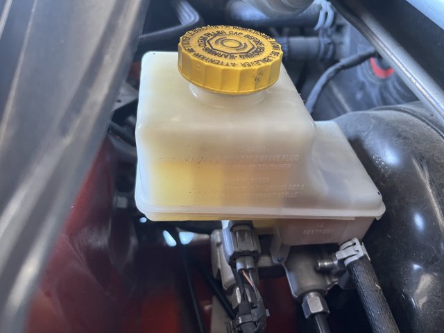

Question about the reservoir though. Why does half still look dark (right side) and the half looks new (left side)? The fluid coming out of the hydraulic line was definitely the new fluid.

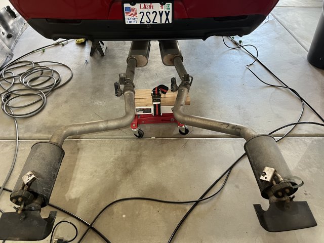

This trans jack was worth it’s weight in gold too. Used it to not only get the trans out but remove/install the drive shaft and the exhaust (which is pretty dang heavy for one person). Appreciate all the advice/comments, shoutout to @16GoManGoHC2 for all the advice.
