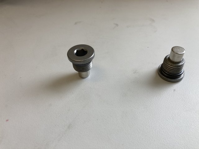

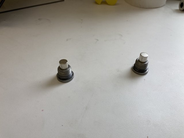

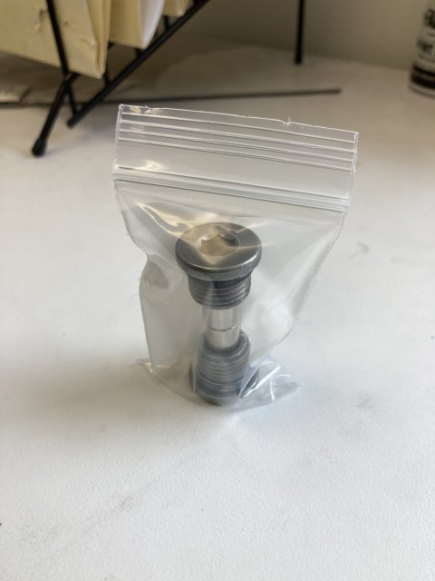

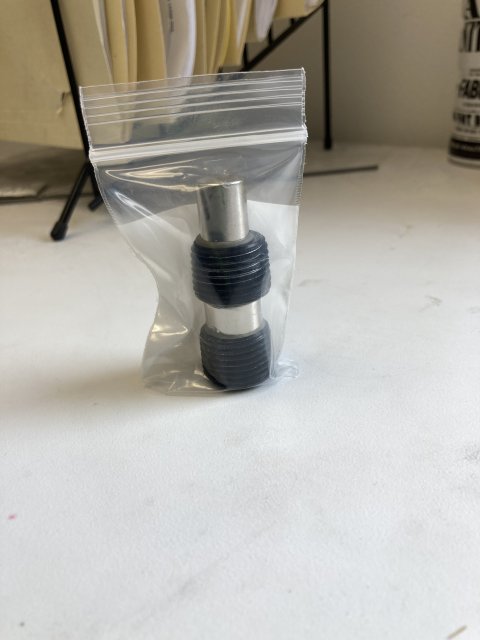

Depends on how rich you are and how much money you wanna throw away LOL throwout bearing would be an easy change while apart it’s only two bolts then you have to bleed it again my suggestion would be bench bleed it before you install it, easy to do, compress it by hand and fill it with brake fluid while slowly releasing it, i large vise works great for such. Me, I just re-lubed the original bearing and it’s quiet as a mouse, you need a needle injector for a grease gun and just shove it in the the side of it and pump some good sticky Grease in it takes care of that. Taking the bell housing clutch and everything else off is gonna cost a bit of labor money, getting the bell off is a more bolts and wires to move. my pilot bearing when I took my transmission out the grease inside it was brand new looking it’s a yellow grease remains tacky wasn’t dried out at all. Myself I would leave everything under the bell housing alone unless there was a shit ton of dust inside it which would signify a lot of clutch wear. I would just clean the spines of the clutch discs and the input shaft, grease it with the proper grease (Dow Corning 44 Light) and put it back together and see how it is. Being that the clutch releases just fine sitting still with no drag I doubt any of the faces are warped on the pressure plate, the center member or flywheel. If you do it yourself you don’t even have to put the trans on the floor just back it up enough to get the throwout bearing off clean the shaft clean the spines of the clutch discs grease it re stable it while it’s aligned and put its Bolts back in and put it all back together and ride.
If you have money to spend by these magnetic plugs for the trans and the Diff $100 +9 dollar shipping gets you all four :). I have some ready to ship finally.
03BCA4A1-C24A-4FC7-A4A6-D4FEC5C8BD94.jpeg C1DE3A03-CBCE-4DC8-8B00-988A745C650A.jpeg F649E311-DC96-4A3B-962B-1BDDA8216E0F.jpeg C680E868-EB71-4005-B96C-63128536B258.jpeg
Edit-correct spelling and wording errors from voice to text

So this picture is the trans removed from the bellhousing? I was thinking about whether or not the throw out bearing (or whatever we call it) would stay on the input shaft as I separated it from the bellhousing but it appears that won't be an issue.
Drop the exhaust, mark the flanges for alignment and drop the driveshaft, remove the shifter, then separate the trans? Doesn't look like I need to drain the fluid, right?
And where did you get that trans jack, that thing looks sweet? I would like to do this on my quickjack if able, hopefully I'll have the clearance.

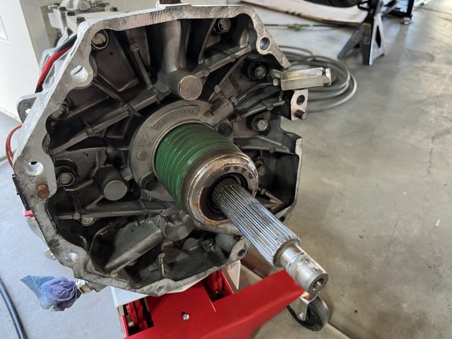

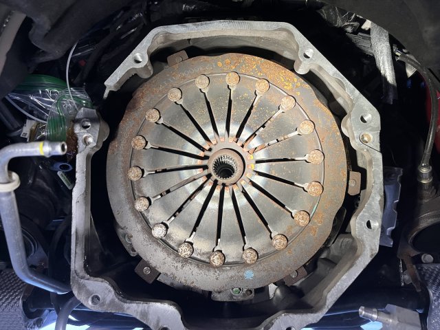

Got the trans out today. All in all it took me about 5 hours. Could’ve definitely gone faster with a helper. Pretty straightforward job but you gotta have a decent tool selection and definitely a bit of experience.
The input shaft indeed feels like dried up sticky grease. I bought the grease from the dealer yesterday, using the part number from the 2009 star case for this issue. The dealer told me it was the correct grease for what I was wanting to do but it’s definitely not the same as what is on there now or what @16GoManGoHC2 recommended, so I now I’m on the hunt to get another tube of grease. Problem is, I can’t find it in town, so it might be mid next week before I get to it.
Everything looks fine other than the grease. Surprised by how much rust there is but I’m guessing this is from being stored over the Winter and moisture building up.
Probably a North East car..not stored in a heated environment
You sue are going through a helluva lotta work:unsure:
