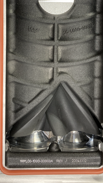

Look at the Revision on his blower, E, mine is a J, glad to see mine is newer but so many revisions already?? Sounding like IHI now with the 2.4 lol.

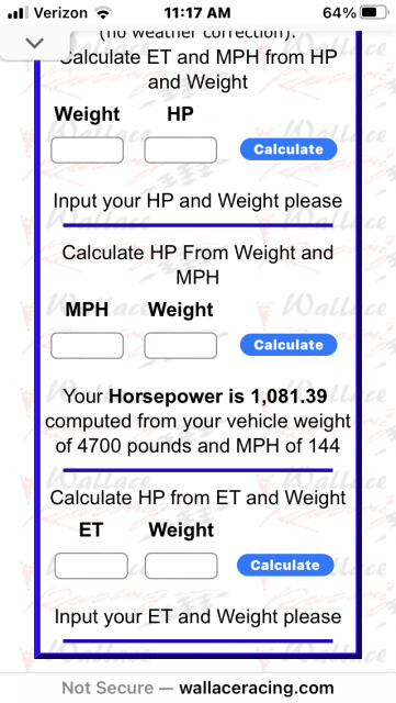

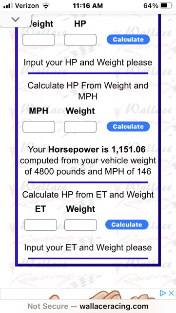

22.7-8 solid 23.6 peak in 2300 DA
RE cam and JBA 1 7/8” shorty headers through cats and stock exhaust. Estimating by 145 mph 1/4 times and 5.22 60-130 times probably around 1050-1150 wheel at the moment. Was supposed to dyno today but it’s raining here all day :(

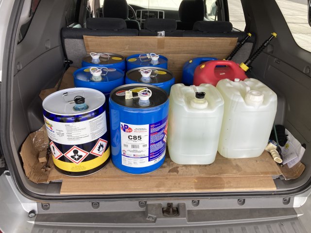

I run simple old pump flex fuel, it’s 82% at the moment, I stocked up yesterday lol. As it’s cooling off and they’ll start to dilute it with gasoline soon and raise is price. I have 100 gallons on hand now. I only run 19 degrees of max timing

How long does it take you to use that? How about staying fresh?

I treat it with 1oz per 5 gallon of Lucas E85 stabilizer, fill the containers to the brine (as little air as possible) and store in a stabile 70F dark corner of the shop. Last for a year no problem. I’ll use pump fuel first until it goes below E78 (I test every fill, even tested between every fill of every 5 gallon pail yesterday, it’s easy with my Kent Moore Fuel analyzer.

I'm concerned with the high temperatures, humidity and the little bit I run the car. Local VP guy told me that a drum wouldn't last for me.
Just seems like a great alternative for what I do.

Thats why 5 gallon pails are great, you don’t have the air volume to worry about like in a 1/2 drum etc. But it you put a desiccant dryer on the inlet of the drum and never see wet air no issue. Even better get your self a very small cylinder of nitrogen plumbed with a regulator set to 5 psi and have a dedicated fill hose with pick up lead to the bottom of the barrel no pump needed, just put hose in car and fill via the pressure of the dry nitrogen. Add a little Lucas E85 treatment to the drum when first opened and it will last 2 years that way no problem.
