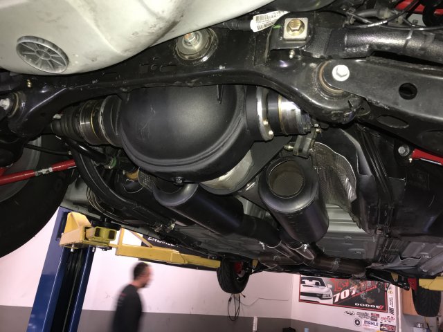

No diff brace needed.

The $10k number was what some were guessing it was going to be priced at. Carlyle responded that it was going to be way less than that. When you consider that HD axles from DSS are $1600 and the Driveshaft is over $1000, if this comes in at $5000, that would put the whole conversion at $7600. The package cost of the DSS 9” conversion is...... (wait for it). $7600. I have no idea what this work of art is going to end up costing but for racers who have scattered multiple stock differentials and ended up on the trailer early on those days...... it starts looking reasonable.

Carlyle is collaborating with DSS on this. It's designed for the DSS axles and driveshaft. I've seen mixed reviews on the DSS driveshaft. I know of multiple that have failed.

While something like this (or either of the other 9” conversions) are not for most, the ones who have taken performance down to the very low nine second range and heading for eights with full weight cars that are not significantly lightened are not going to deal with repeatedly breaking the stock differential. Marc H with his 9.0 Demon went thru something like five of them before going with the DSS conversion. Now with hundreds of passes he hasn’t had one problem. I just installed that conversion in my build because I don’t need to repeat his experience to benefit from it. Yes these things are super expensive. So is hauling a car across country to run at a big event and breaking. The long tow back home with nothing to show for it but the $1000 expense is not very satisfying. I know some look at this stuff a waste of money by guys with too much of it. Apparently they have never been to the drags and looked at the Pro Mods and Outlaw cars. Lol. This is cheap by comparison.

That diff looks serious. Hopefully the gear setup is good. Buddies that have 9" conversions struggled a bit with gear whine.

Yeah. I have a DSS 4” aluminum for over a year and haven’t had any issues with it either. Just like motors... luck of the draw. The big deal with this announcement from Carlyle is the 2.75 and 3.00 Pro gear sets. Those are what all the 9” guys have been waiting for to use with the A8. According to Carlyle they have managed to have those made for them and and will be available thru them. Those have been rumored for some time now and apparently Carlyle is making it happen. These Pro gears are not for street driving (at least not daily driving) but are pretty much unbreakable. At this point whine isn’t really a concern. 😂

For as beautiful as this is, there is a reason Dodge put a solid axle under the Drag Pak cars: reliability.
This is the same reason that I scrapped the idea of using a 30 year old 8.5" GN diff in my wagon and went straight to a Strange S60. Brand new, beefy, and no worries.
