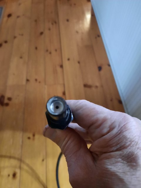

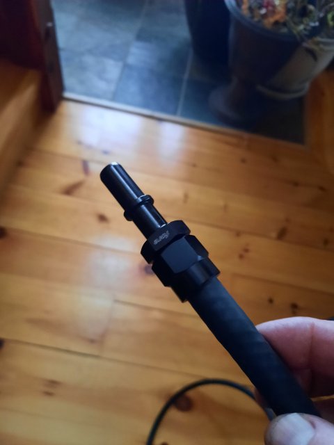

this thing is so simple an works so well.
so the way it works............. the 1/16 inch hole is a restriction causing pressure in the fuel line as well as slow the flow which causes the pump to pull from both tank saddles till empty.
without that tiny hole the pump will cavitate quick an will not pull fuel from opposite side.
all it is, a fuel line fitting with small automotive frost plug shoved in the end an then drill a 1/16 hole. the fitting is made by fore. attach hose of your choice on the end.
the key to it is that restriction.

race fuel is so expensive I want to pump all of it out after being at the track.
save for next time.
the rib on that fore fitting is thicker than factory steel fitting making it harder to install an remove lock clip so I suggest a oem fitting off a car at the wreckers an make your own.

OK, so this fitting goes at the fuel line connection at the fuel rails ?
Wonder if this would put too much pressure on the F pump ?

Maybe FMSI has something that would work. They have lots of repair lines for fuel systems. You know like the gm fuel filter repair stuff.

not at all, just enough to make it work. I have a hoist an I find it easier to do the disconnect at the frt of the tank, I find at the fuel rail to be a pain.

And we are talking about this working for the stock hellcat fuel pump ?

I still have a stock pump with a JMS booster.
under normal driving your pump is under far more stress from higher pressure.
this would work on yours for sure.
