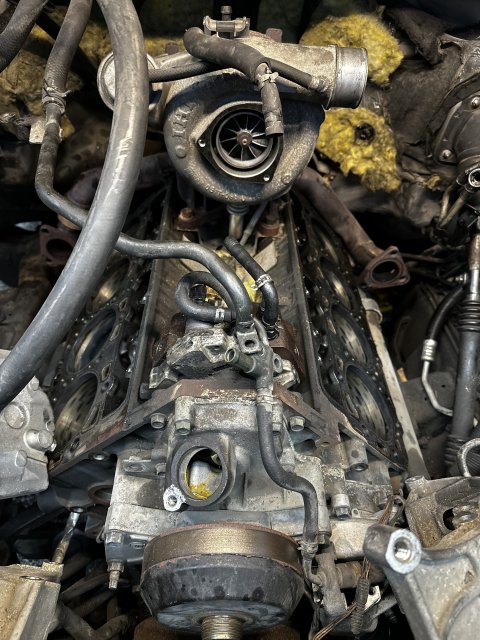

Doing head gaskets on my duramax right now that took my time. Will have buildup after truck
jgilj
#1483
1,572
13,467
Walland
21 Challenger Super Stock
Oh that’s a fun job! NOT ! Although not as heavy as a Cummins head😮
Hatermkr
Hatermkr
#15491
1,279
2,652
West bend
WI
2016 helldemon
Thread Starter #30
Nope not fun add 401,500 miles on it
jgilj
#1483
1,572
13,467
Walland
Oh lord I’ll bet you said a few swear words here and there 🤬

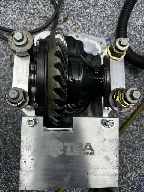

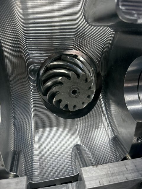

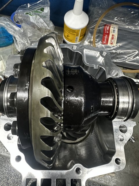

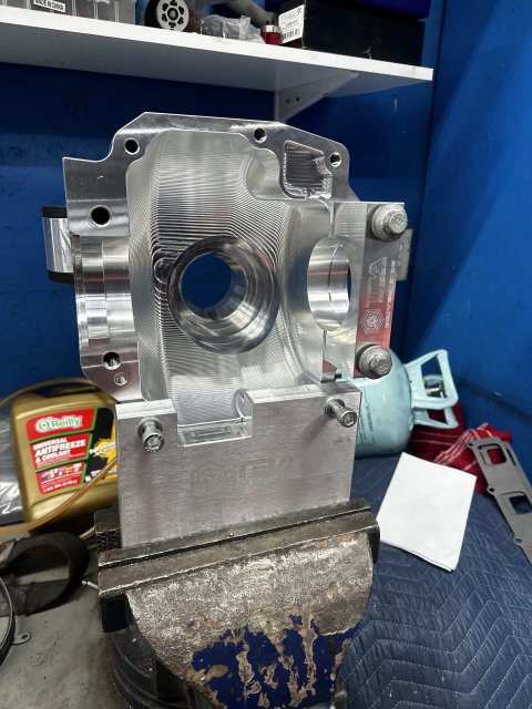

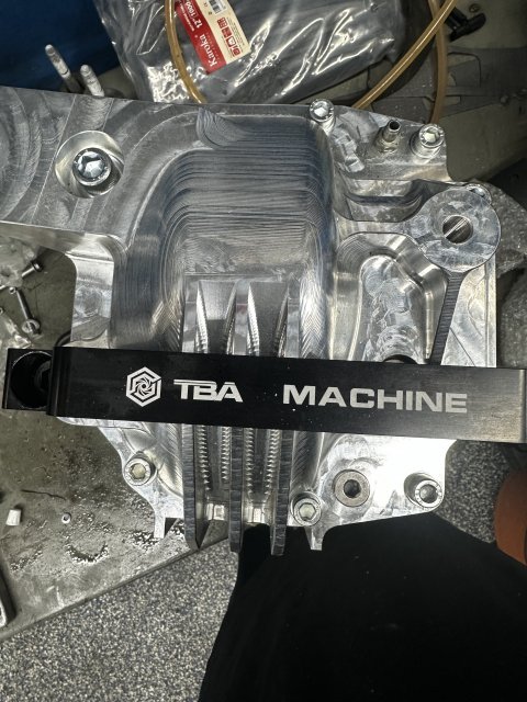

Update. I had time to get this together. And compare to the one aj sells.
Plus on this one over aj.
1) case looks better
2) snap ring that holds everything together is cut Deeper and will not fly out have seen this on other diff
3) more room to add shims to get back lash correct and preload for carrier bearings
Threads are cut better for fill and drain plugs
dislike about tba can not use performance development brace but TBA sent me one of theirs.
over all you can set this one up and not have to fight with it. They give all shims and seals needed if you buy just a case. I put a wave track in mine
D611C6B6-6118-4E5E-B9D7-76FE1A4289BC.jpeg F8262A13-1690-4C2F-B233-E1A59496323F.jpeg 8AF6A75A-0532-4C62-A4C7-23C66A455706.jpeg F8289E6A-0B9B-45B8-9108-91EF19D221E0.jpeg 6DAFD0B9-F4EC-4F69-BE16-A3F5206A7524.jpeg
7,964
6,840
Th
View attachment 104094 View attachment 104095 View attachment 104096 View attachment 104097 View attachment 104098
anks for doing the compare! Looks beautiful. I doubt you even need a brace with it. I wish you could put internals other than ZF ones in it. So you have to buy a XF diff and take the guts and swap them over? Has to be a better way
Wave track makes a carrier that’s what I put in
