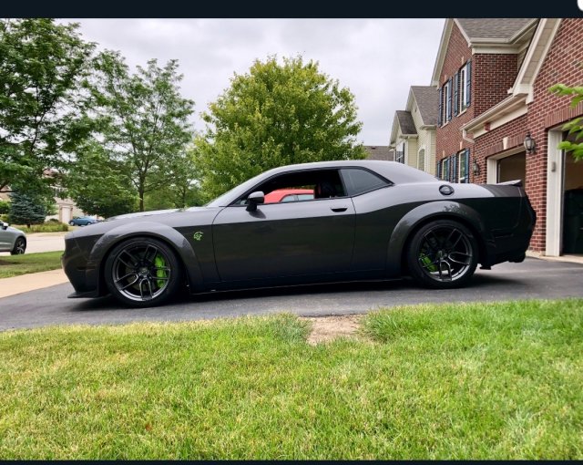

If you blow up my pic you can see I still have plenty of room especially in the back. @BULL I can agree with that just thoughts per say.

I still have mine on.
