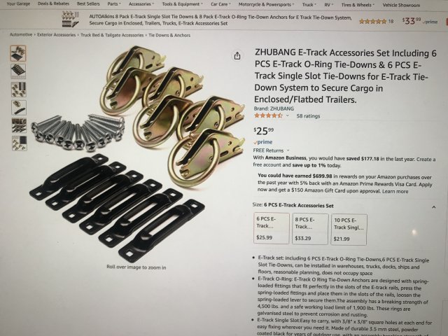

How are you successfully tying down your cart? I'm having a tough time getting my atv to stay put so I'm not taking it.

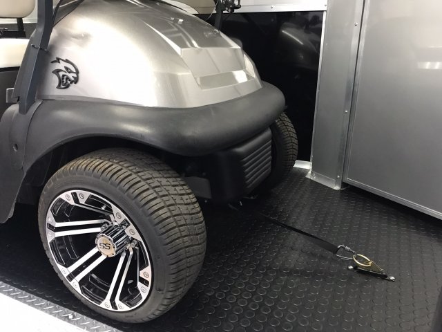

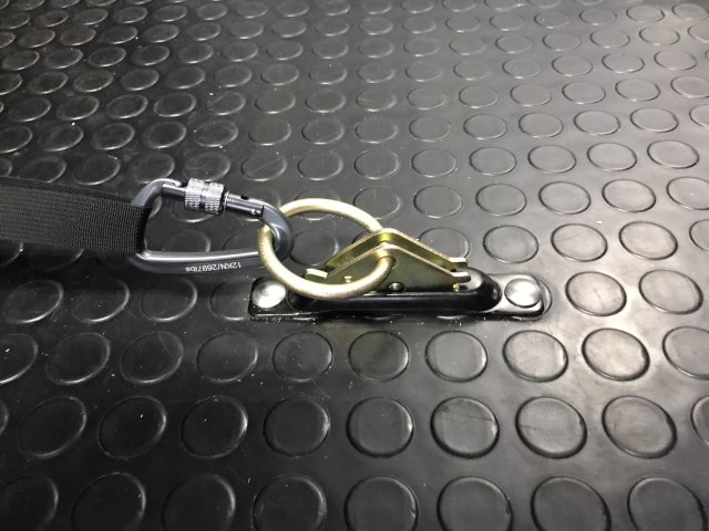

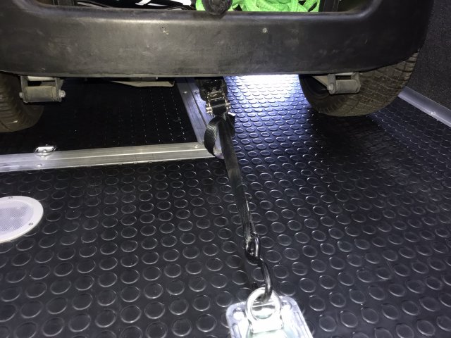

E-Track. It’s a tie down system commonly used in trailers. The track fastens flat to the floor and there are a bunch of different attachments to be used for securing stuff. You can put it on the floor or walls. I just used the single attachment point but you can get in strips with multiple points. D01244D4-CAB1-412F-9B78-E6C8BB9FC61F.jpeg 264C10BF-9455-4D3A-B0FB-1664E4649D48.jpeg F63E58A6-9CE7-4D82-828D-A62DFBF710C4.jpeg 1FF6020F-B8A6-46C4-920D-FFDBDCD9D689.jpeg

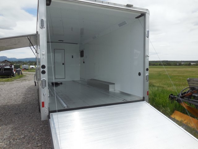

For the most part I use that kind of setup, largely because on the flatbeds all I have for anchor points is the stake pockets. In the toy hauler I have E-track and can use wheel nets or tire straps.
The latter are a little more work to use, but there's nothing touching the wheels, which is nice. Either way, I never tie any vehicle with suspension to sprung parts, only to axles, wheels or tires. DSCN2683.JPG

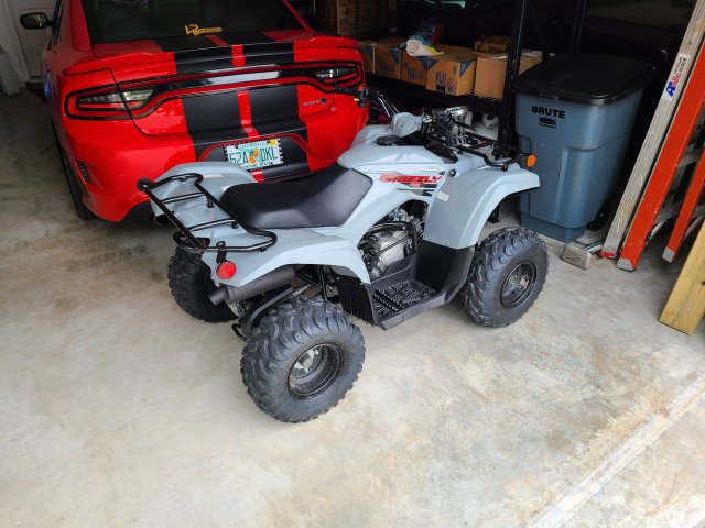

I have the hold downs installed in the floor, just need some type of straps that go over the wheels with a single point of attachment to the holddowns.
The suspension has so much travel that attaching to the frame it won't stay secured, especially on rough roads.

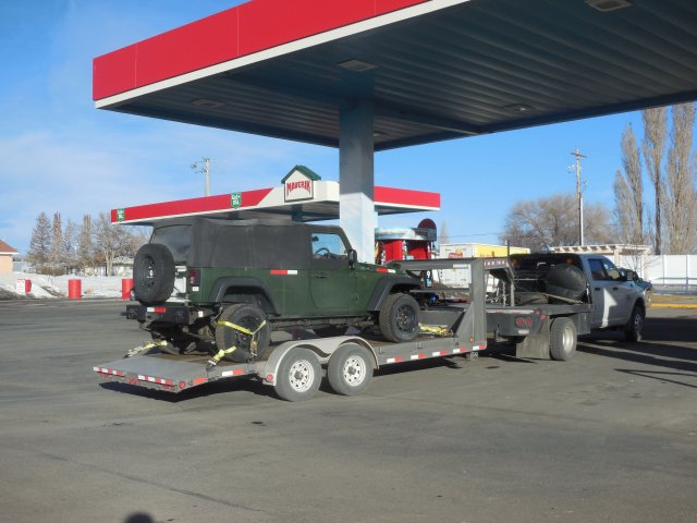

I have the hold downs installed in the floor, just need some type of straps that go over the wheels with a single point of attachment..
Look into lasso straps. Inexpensive and effective. As seen on the rear in this photo. DSCN3115.JPG

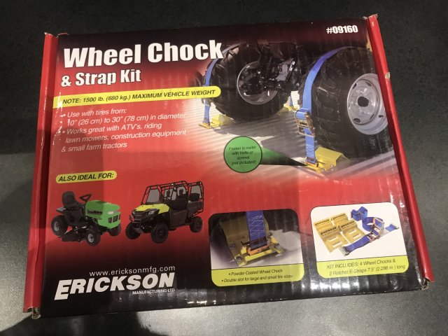

Here’s the ticket. Made specifically for that. I bought these when I was using a ATV and never used them. I would sell them but shipping now would be prohibitive. You can get them on Amazon prime for less than I should have to charge. 799D02A9-FD92-4869-9A59-7394AA78A01C.jpeg

Are the chocks removable? I'm cramped for space.

The chocks bolt to the floor and the straps use the E-Track part of the chock. You should be able to zoom in on those pictures. If you need a absolutely flat floor there then just get some flat E-Track and ratcheting straps with E-Track attachments and go with that.

Then I'll just find some lasso straps. Thanks guys!
