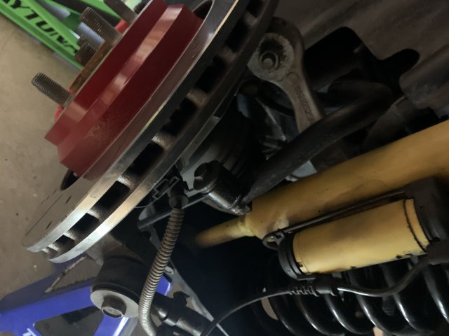

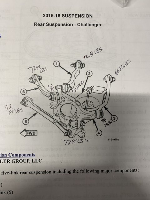

So recently I changed out my sway bar end links with HHP Racing shortened end links. I also changed out the stock springs with HHP Racing springs. When driving slow or in a turn (body articulation) I hear a clunk under the car as if something is contacting the body. I have been underneath the car multiple times this week and have double, triple and quadruple checked all bolts to ensure they are tightened and still there. Things I have checked.
- Motor mounts: thought I might have broken my new solid ones.
- Exhaust: checked the entire length of the car, everything is fine (just had muffler and resonator deleted).
- End Links: Just installed the HHP Shortened end links (have 17" race stars), bolts are on and tightened to spec.
- Front/Rear Springs: Just installed the HHP Racing springs, everything looks fine.
- Drive Shaft: Have a DSS solid drive shaft, checked for any marks on it and none. I used a grease pen on initial install to make sure bolts didn't move and absolutely none of them have moved.
- Differential: Just a cursory outside look, honestly if it was this, any gear would let me know it was busted.
- Axles: Gave them the move by hand test, everything seems rock solid.
