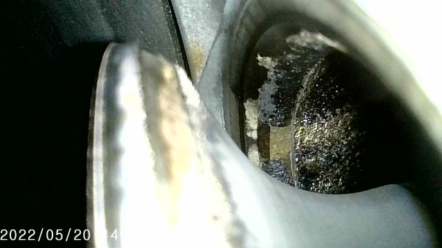

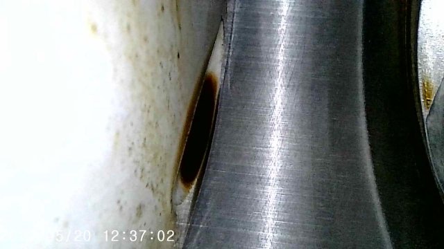

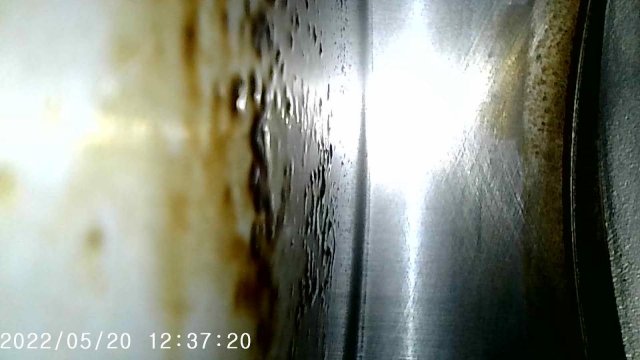

im going through some stuff right now…
Not blaming installer or builder. Just want it fixed. I think I'm cancelling the rest of my travel for the year and racing events. Kind of at my limit mentally.
Ignore time stamp as my boroscope doesnt keep time.

New engine rings not seated?
4,149
10,439
Thread Starter #1,566
I dont know but that valve is fubared
8,820
7,739
sounds a little tight yeesh
3,828
9,073
Piston to valve clearance not enough or cam installed incorrectly? There’s why she loped so much? Sorry to hear, you don’t have good luck much do you.
8,820
7,739
How does a valve get burnt so quickly
8,820
7,739
really sorry to hear about your bad luck man, hopefully builder makes it right

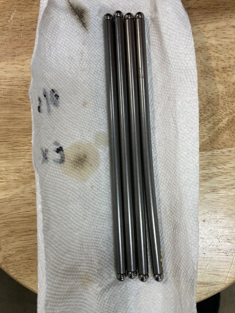

I had that cam bent push rods

8,820
7,739
That wouldn’t cause oil in the combustion chamber though. Ring gap had to of been junk and judging by the huge slow lope there was probably horrible compression because of the rings

8,820
7,739

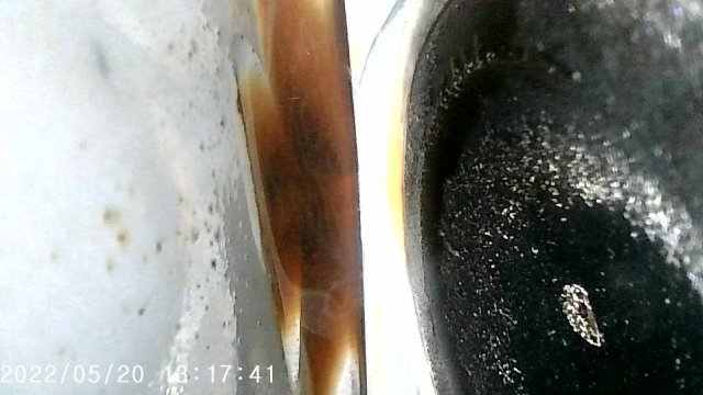

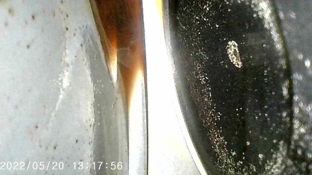

aren’t those supposed to be new heads? There’s so much carbon buildup behind the valve I don’t understand how that can happen with just a few startup miles if that
4,149
10,439
Thread Starter #1,579
220 miles. All normal logs. I have all those miles logged as @Jon-MooredPerformanceLLC was along for the gripes/ride. Installer is working on getting me in. Told him I don’t want the motor as it has junk run through it at 220 miles. That valve didn’t destroy itself so what did?
rings should have seated already or rings were trashed to begin with, set expectations with installer that if the builder wants the long block back, they are to send me a different one or refund my money. I do not want a motor that has trash in it ever, just a ticking time bomb.
