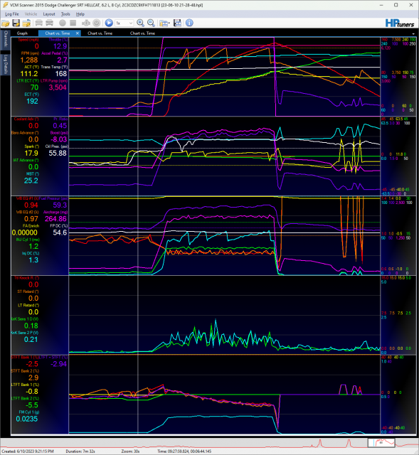

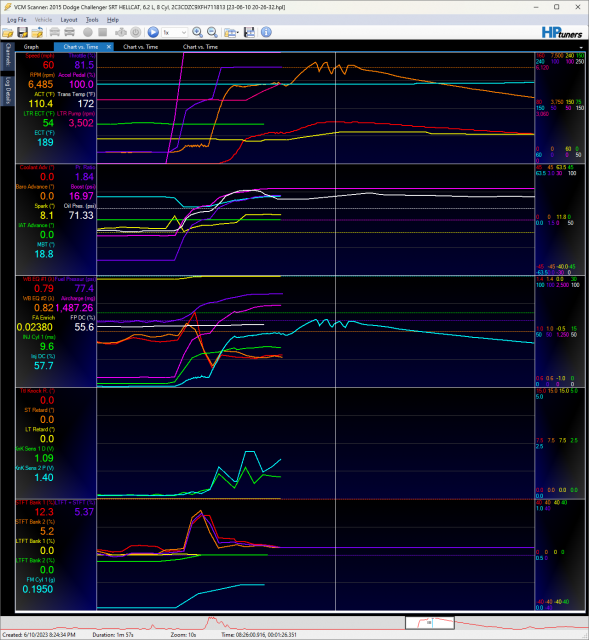

Attaching two logs just so you can see what the two step is like. One of the things that has me most excited is that the throttle is open and the cold air is coming in and the IAT's are dropping. God bless the IC Chiller. Compared to power braking the car gets hot quicker.

The experiment is over. Two step is for sale. Car leaves on way too much boost. Blew the tires off every time. Will include harness, led lights, foot switch assembly and bracket and 2-step box.

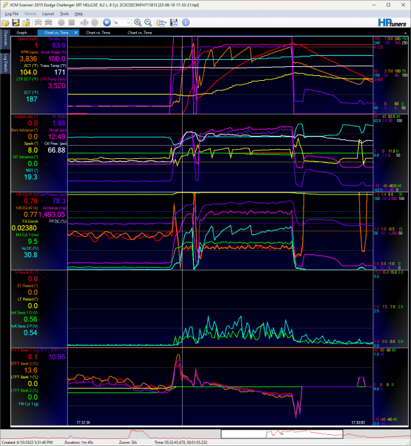

^ Track couldn't take the hit, was leaving on 12PSI. Spun like a mf'er 10.xx @ 14X mph

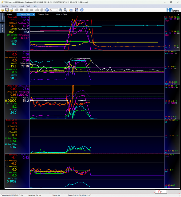

^ Too high of a burnout and banged off eight at 218mph. Transmission through a U0402 implausible data. This was my fault forgot to put the paddle shifter on when doing a burnout. Car was not happy.
^ left so damn hard It banged off second gear four times before it went into limp mode. 68xx, 68xx, 66xx, 66xx. Not a good situation. Decided fuck this 2-step.
