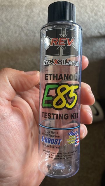

It’s time. Picking up three jugs this evening.
4,385
10,911
4,149
10,439
Thread Starter #679

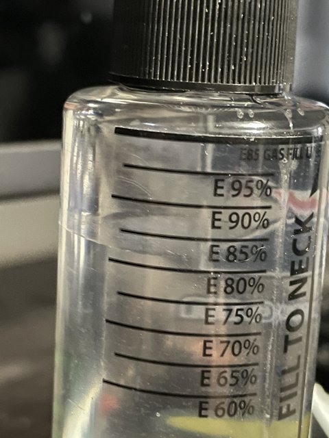

Got about 15 gallons. Testing e82.5?
63,111
220,423
about where mine has been. This week it was 85% though. I have only been using one station that is just down the road from the house
