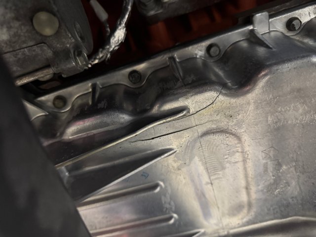

Crack in the pan can be welded at least.

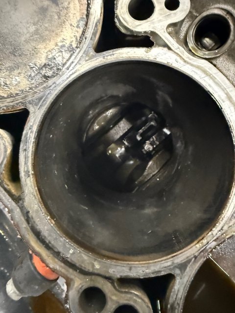

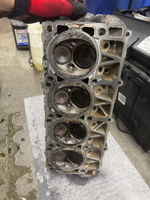

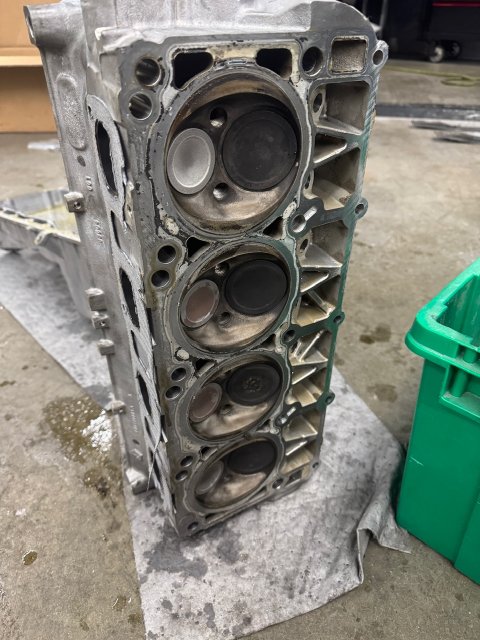

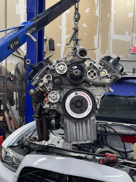

Cylinder six and five need sleeves. Crank should be save able, machine shop will determine if so. Thank y’all for 2024. 2025 is going to have a lot of free time 😅
