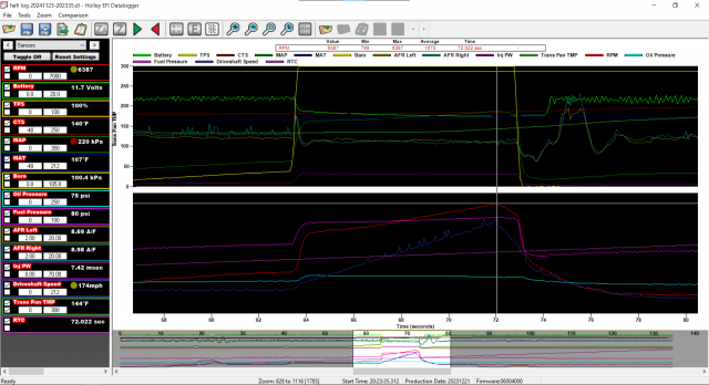

Also peep that drive shaft speed sensor... it's doing it's thing!

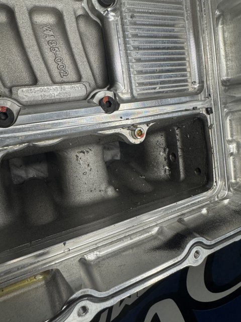

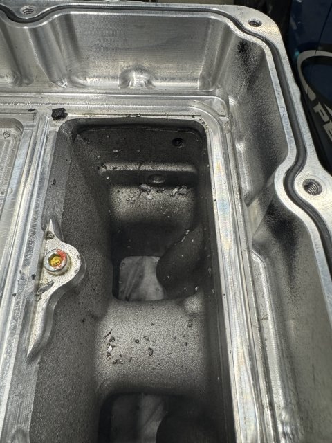

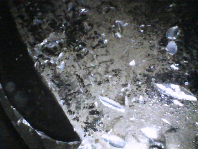

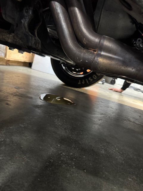

Well guys, may we have a moment of silence. RIP Hellcat block 2015-2024. You set the world ablaze one quarter mile at a time and owe me nothing. May Jesus smile upon you. I haven't pulled the block yet as I'm trying to ascertain what's next if there is a next. I may decided to put a LS motor in it. (this is not a joke I'm dead ass serious, I can get a 427 turn key for less than a hellcat longblock.). I may also just build a 458 stroker and go NA.
8,763
7,687
View attachment 151738 View attachment 151739 View attachment 151740
No!!! That sucks man I’m sorry to hear it. Guess there’s a hole in it?
4,143
10,433
Thread Starter #674
There is no hole in the block. There is a crack in the pan, the pan can be re-welded, will know tomorrow if the engine is salvageable, beginning teardown at 8am.

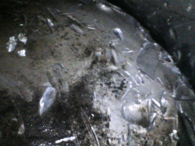

Cylinder 6 said yeet. Motor is trashed based on the cylinder walls. You might be able to bore over 4.095 or 4.1 to clean it up but the gouges are too deep. It may live in the future but not for march 2025. May sell chasis as a roller and get out of the mopar space and build an LS

What broke? Ring land?
4,143
10,433
Thread Starter #679
Havent been able to tear down block, motor is seized and cant get to convertor bolts. Will have to drop as one piece, going to assume a rod ate it

Go big or go home, blower is Absolutely fucking trashed, rotors are locked up.
