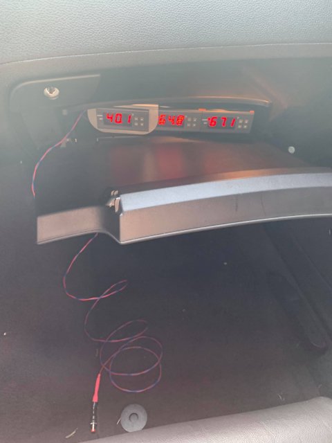

Check out our latest testing. 0-80 pull on the street 27* delta full boost, proving once again stock pump 2gal water and Chiller all that's needed. Will have more detail after Cadillac Attack.
before and after chiller and after reservoir/pump
