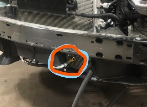

Car is currently at the shop right now having issues with KC install.
-Dodge couldn't recharge the A/C system since everything goes by vin/computer system - Wouldn't allow more than factory R123yf. Shop car is at now has to buy equipment to do older R134a. - Warned the seals and compressor may fail after 5 years with the older stuff.

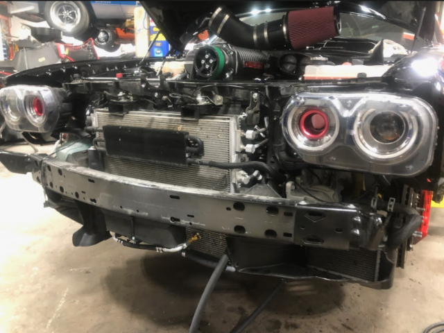

-Killer Chiller location doesn't look optimal/off IMO. Installer said he put it there for cooling - Requested in the crash beam or under the light. I think it's blocking airflow, what do you guys with kits installed think? Need to move it?
Been playing phone tag with KC and the shop since they couldn't get in contact with each other.....not having a good time o_O
Last thing holding the car back from being home! Any help or knowledge is appreciated.
Not sure what this is going to or if it's just hanging there. My Drive - Google Drive - Google Chrome 10_27_2020 3_11_01 PM (3)_LI.jpg

With KC installs, the biggest mistake one can make is in choosing a shop who has never done one of these on this platform before.
With that said, that KC core doesn't need to see any airflow on it. In fact, it's blocking some airflow to the a/c condenser which is a critical piece of proper a/c (and subsequently killer chiller) operation. I have my KC installed where my auxiliary heat exchanger used to be on the driver side. I also bypassed the primary as all it does is fight the KC when it's setup properly. The KC has the ability to drop I/C fluid temps far below ambient and all the primary heat exchange will do is heat it back up.

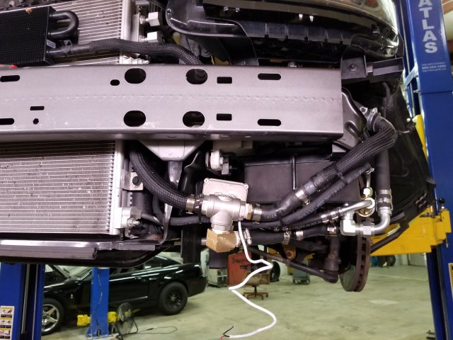

I guess you didn’t see all the pictures I posted on how I installed my drag size KC with HX bypass valve and drag valve and a1.2 gallon hopper tank and except for the insulated lines you’d never know it’s there? PM me a phone number and I’ll txt you LOTS of pictures including charge pressures with 134a

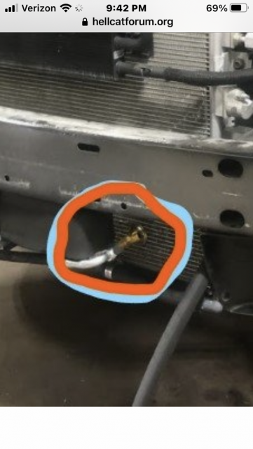

PS, that “thing” hanging is the TXV valve, it controls how much liquid Freon is allowed into the HX to evaporate and get cold in that process. If the capillary line to it is kinked it’s not going to work at all. Look at it closely for such. Also it’s sensor must be tightly up against the inlet chilled water line so it can control the Freon flow correctly. 87134DF3-036C-4E04-A456-733E6A99C8D1.png
I saw your posts just was a bit confused how it all works with two way and three way valves together. - Sent your thread over earlier today as its very detailed step by step. I think it will help out quite a bit.

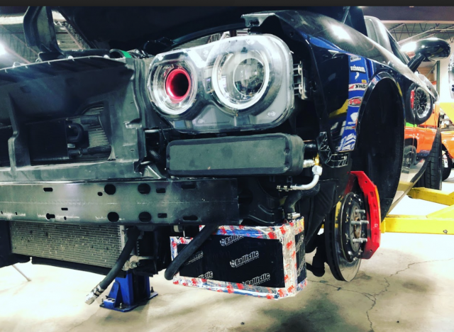

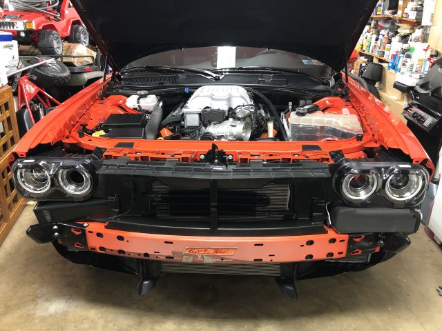

The installer wants to leave the killer chiller in front of the A/C condenser for airflow and to keep hoses facing down per Joe's instructions @ Kincaid.
I sent pictures of two other cars, one with the chiller installed under the driver light and another where the new coolant box is located now, so that's off the table. Shop doesn't want to put it under the light since hoses will be oriented sideways. Thinking cutting into the crash beam is the next best option. Anyone have ideas? Should have more pictures of the custom coolant tank setup later tonight.

Per Kincaid hoses can be side ways as long as Freon lines are on the bottom which they are mounted like I mounted mine under the DS headlight and hopper tank under the PS headlight. With insulation on them they fit on those spots snug and tight and the insulation let’s them float from vibration. No hoses, valves, nothing seen except for the insulated hoses in the bay to the back of the super charger.
