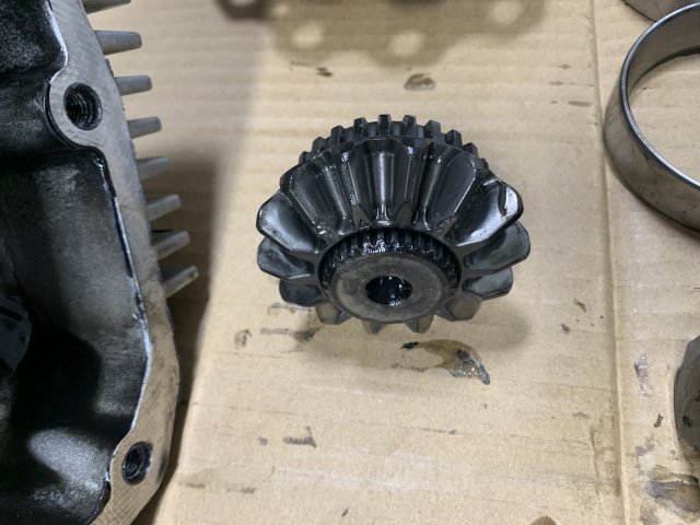

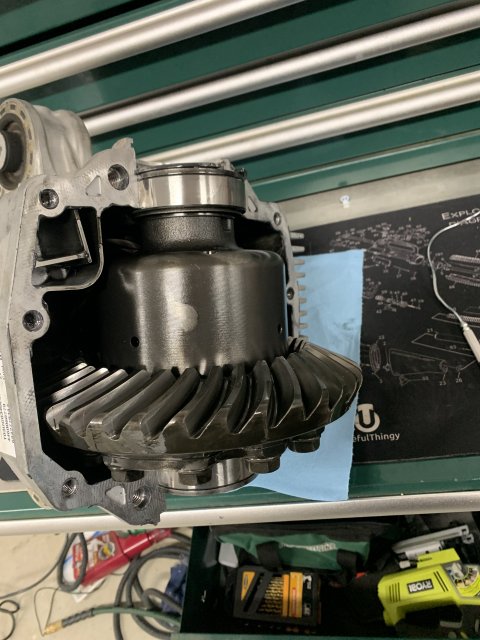

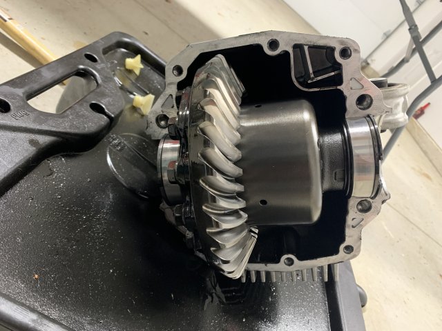

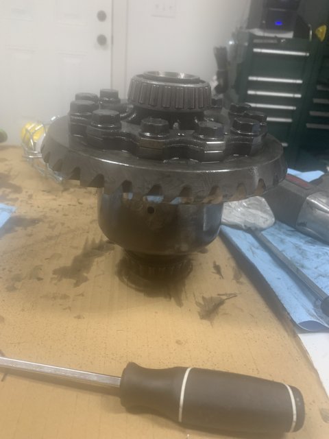

So the axle is out. I split the case tore it apart.
next time I’ll just do this. Way easier than all the time I’ve wasted.
I have to finish putting the diff back together.

What are your thoughts on using this Diff or not?

To me everything looked in fine shape.
