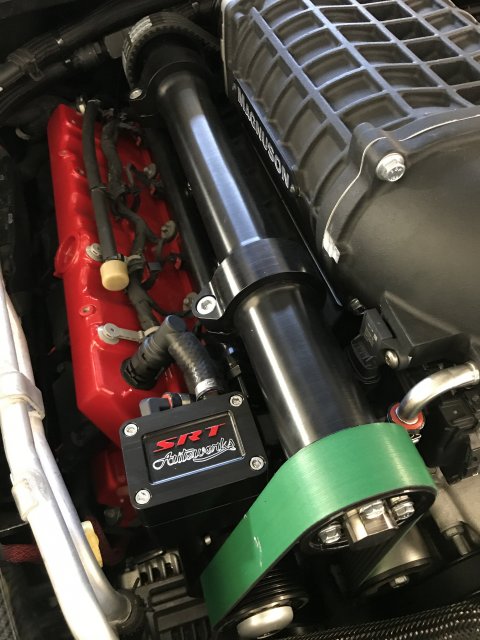

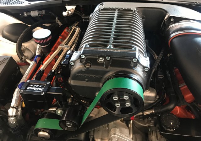

Yep. When you look at the belt wrap on the Maggie compared to what I’ve got going on my Whipple, it’s obvious that it could use more. 9AF44A65-654A-45F2-90A1-E36372EC23F6.jpeg

Yep. When you look at the belt wrap on the Maggie compared to what I’ve got going on my Whipple, it’s obvious that it could use more. View attachment 15628
I wonder if the direction the tensioner pulls in relation to the SC pulley makes a difference?
3,631
11,716
#68
Yeah it pulls away (or out) from the pulley so it isn't helping any. That billet tensioner is killer compared to the stock tensioner. We had to put one on mine and that belt is under control now. We threw the belt with the stock one. I'm betting that with the idler increasing the degree of wrap on the pulley along with the Griptech will fix this problem with the Maggie. It would just be nice if they had that information to start with.
Yup your right on the money with 80% of these dam sales people. They don’t know a dam thing about the product their selling. Now Grip Tech had outstanding customer service, now let’s see if they send us the right pulley lol. Then this morning on IG Magnuson reached out to me stating hey reach out to Grip Tech we use their pulley’s all the time...🙄🙄🙄 I’m like really! Could of told me me that from the get go😡. It’s all good though...... I learned a lot from Marc and Tommy these past 2 days. Oh ya 1 more thing..... from having the 3.0 Grip Tech pulley, their tech said I will gain about another pound of boost because hopefully zero slippage.
